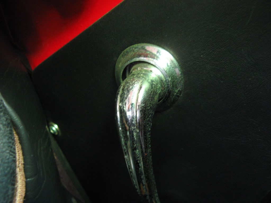

You wouldn't happen to have a picture would you?
Thanks,
Jim
Below are photos of my BN7 original handles with and without escutcheon. I think the one with escutcheon is not fully seated due to stiffness of my door panel. I couldn't get the driver side to stay on. Hope this is of some help.
