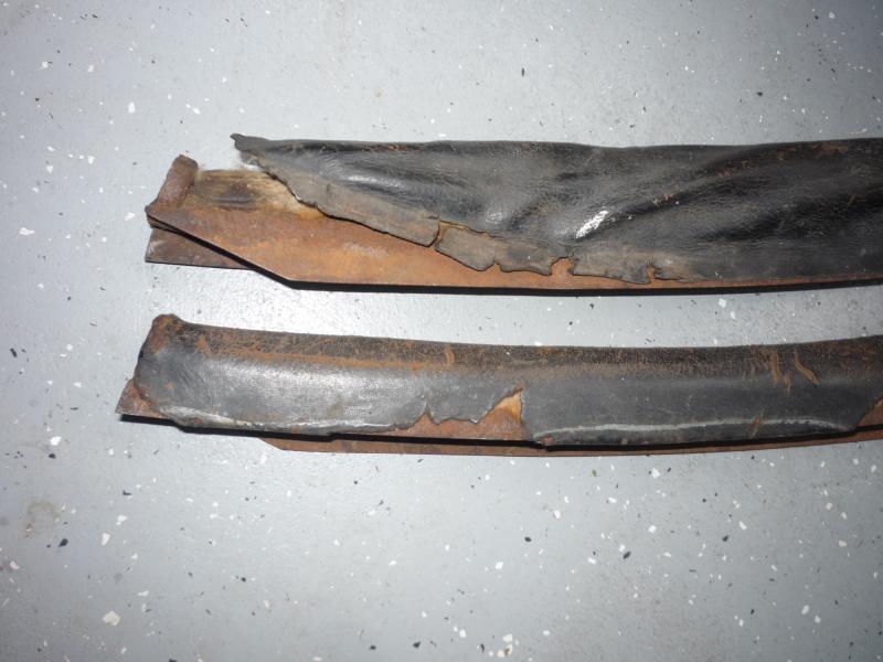

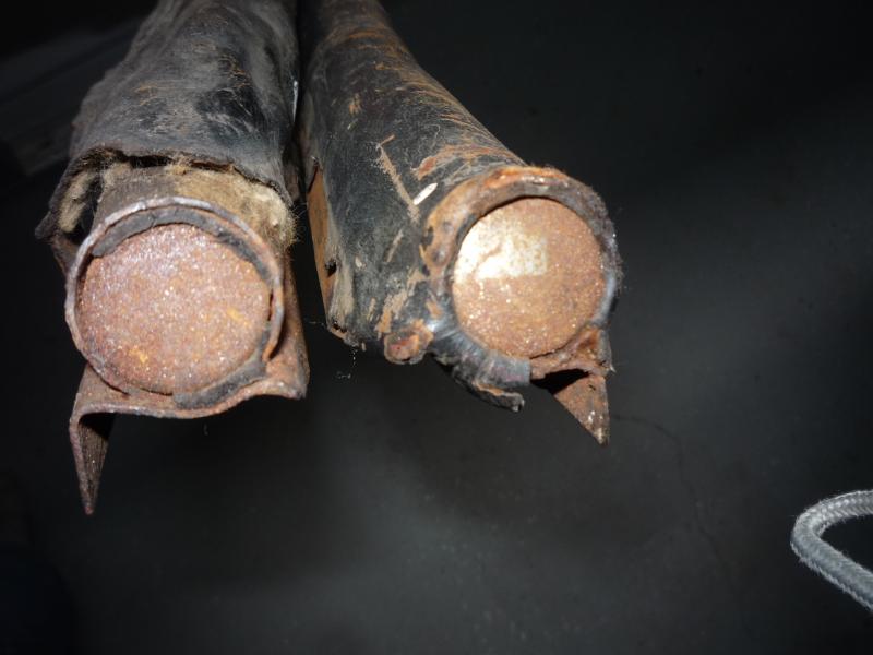

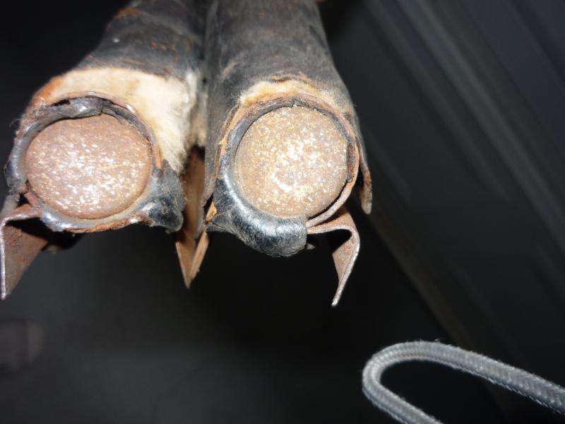

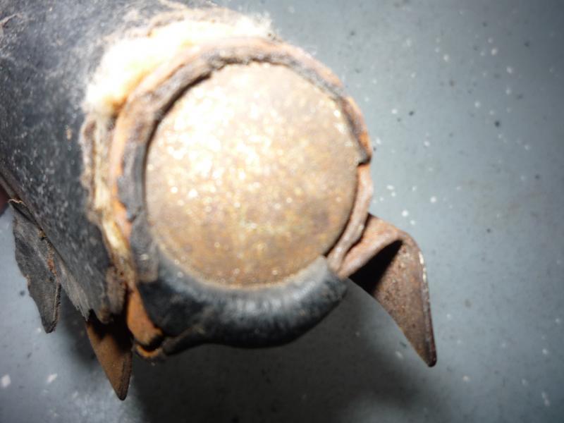

Yes, your trim looks smooth and professional. I couldn't find these in time to help, but at least you can confirm your end-cap look. These are original leather door caps I took off a junkyard car in the late-80s (remember those?). P1110559.jpgP1110557.jpgP1110558.jpgP1110560.jpg
