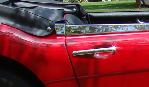

This is the best I can do also. Is yours similar?

Thanks for the replies. No, it isn't that the tops don't line up its the sides. the door section protrudes about 1/2" farther out than the fender section.

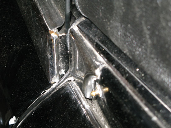

Well, I've already tried filing out the striker holes, it did some good but not enough to make a difference. This is what it looks like, more or less.

Looks like the door needs to go in a bit, also, is the top chrome door piece sitting over the metal upright correctly?
It's hard to tell from the photo but is the edge of the top chrome door piece bent out from the metal upright? It should wrap around the upright in order to slide it over when installing.
The crrome piece is difficult to fit but both the front & back slide over the door flanges. The window trim clips hold the rubber piece to the chrome trim and when you slide it down those clips hold the assembly to the door top flange.
The clips grab on both sides & both sides are different.
Hope this makes sense.

From your picture it looks like your door needs to go in about 1/4" further so the edge of the door and rear fender align. You will have to do this by adjusting the latch on the B pillar. Does the front of the door align with the edge of the front fender ok?
John
the front of the door aligns with the fender. The door gaps are even, I took out the strike and pushed in on the door until it touched the channel that the weather strip rides on (weather strip was removed) and there is still the entire width of the door trim protruding past the fender trim piece.If you look in my post on the window clearance you will see more on all of these issues.
