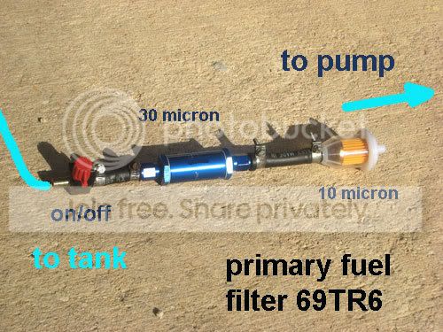

Now that being said, I, after limping home for the second time this season, had to remove the middle carb of the three and clean it of stuff. I could not figure it out. While I had the center one down, I decided to take all three off, take them apart, and clean them inside and out. Amazing.
I was exchanging emails with Rick Patton and he just asked about the fuel filter. THE WHAT? I knew it was there but why bother?
This is a simple fix and I feel a little foolish but I had not replaced the fuel filter that came with the electric fuel pump in 2 seasons. Now once I replaced the filter, Rick asked me what was in the old one? So I cut it open and took a look see. HS!!! It was full of sand, little stones and other little rubbery silicone materials. It looked like the beach at Valdez after an oil spill, without the dead birds and fish.
So don't be "fuelish." Change the fuel line filter(s).

But IMO a better option is a glass sediment bowl type filter that you can inspect and clean periodically.
