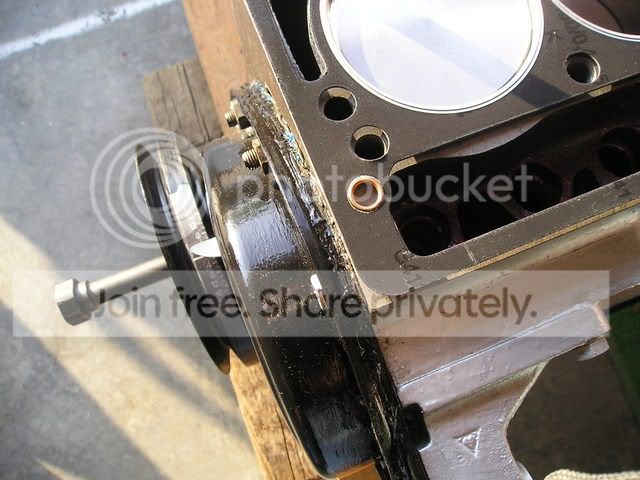

Does this look like a correct head gasket?
2wrench
Hole(s) in gasket; no hole in block.
What's up? Wrong gasket....again?????
Check the pics:
Hole in block; no hole in gasket:
and:
Need help on this one. We all know the importance of
getting this gasket right. Thanks.
In the first picture, there is no hole in the block
under the brass/copper hole.

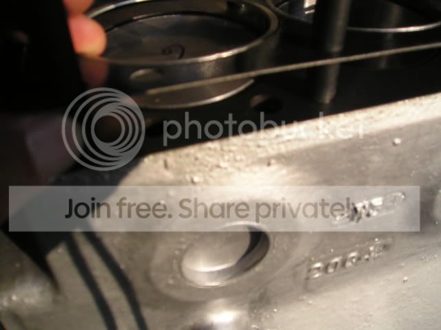

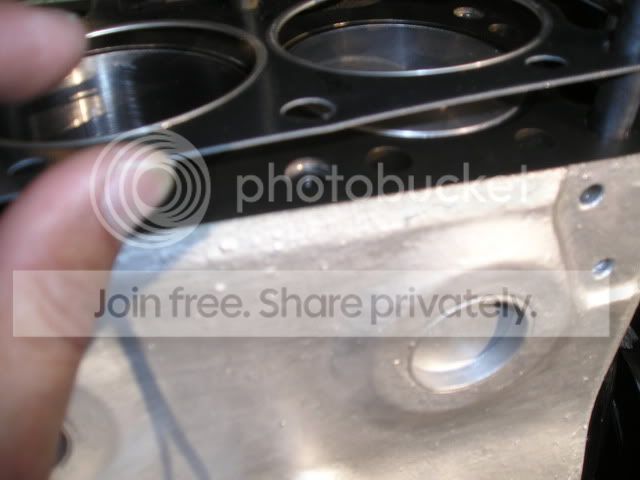

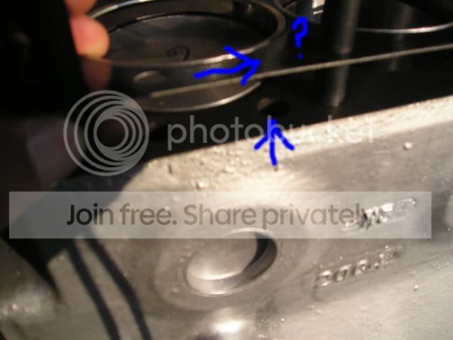

In the next two pictures, two holes in the block are
covered by the gasket....there is no matching hole in the
gasket.
OOPS!!!!! My Bad!! There is no block hole in the front!!
Dumb me......
Paul, check out your gasket at the front brass hole.
I looks like there is no hole in your block either.
What do you think? Did your car run fine with this
gasket in prior to this pic?

I must question why there are holes in the block that the gasket covers up. Seems a reasonable concern, no?
Also, in Paul's picture, the hole at the front of the
block that is rimmed in brass or copper looks as if it's
a hole in the gasket and maybe no hole in the block.
Hmmmmmm...........

what about the hole in the block where there is no hole in the gasket? whats the hole in the block for and why no hole in the gasket? is there a hole in the head too at the same location, maybe post a pic of the gasket on the head before you put the head on

I'm bettin' the head has no passage where that "blocked" hole in the block is located.
Judging from this picture of the head, I would say that the good Doctor is correct again.

As has been pointed out, there are no corresponding holes in the head. Boring the holes all the way through is much easier in regards to manufacturing than try to blind drill them. At least that is what I see in motorcycle manufacturing.
The design simply includes that aspect and deals with by use of the gasket and no holes in the head.
I am sure if you look at the old gasket you will see coolant staining or rust marking these area's.
