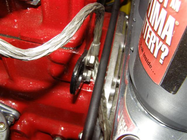

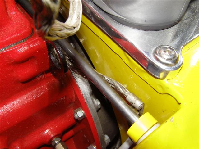

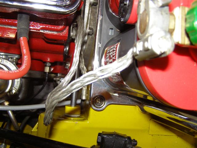

Well, yes, but it's the braided strap that comes from the negative battery post, below the head to the back of the block and then behind the throttle shaft to the firewall.
I had to take three pics because I couldn't get it clearly in one or two.

Re: Does a TR6 need an engine to chassis ground st
Got it - tahanks Paul.
The TR3 an TR4 also have a similar braided cable at the front of the engine to the chassis, but it sounds like the TR6's do not.
(71 TR6) I have the cable from the bellhousing to the battery, with the extra loop in the middle of it that gets bolted to the body. I advise to make sure any ground straps with extra length are kept well away from danger of getting wrapped up in the steering column (potentially disastrous consequences!)
I agree. Mine is normally a lot closer to the head, but I moved it for illustrative purpose only so Tom could see the bolts.
