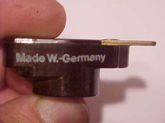

gents,its obvious this is an example of a "german" one ive been getting from a local sports car parts place $9.00 been working just fine,it does have a rivet but no problems except i never asked the name of the manufacturer /ubbthreads/images/graemlins/smirk.gif, will do so i near future.only other markings are on top "remove to oil". /ubbthreads/images/graemlins/savewave.gif i also tried the jag trick it didnt work for me either-keoke?. /ubbthreads/images/graemlins/confused.gif

7777, I used the Electronic version of the 1985 Jag XJ6 rotor in the Healey Dizzy,and it works ok.Of couse I do not use points so?---Keoke
