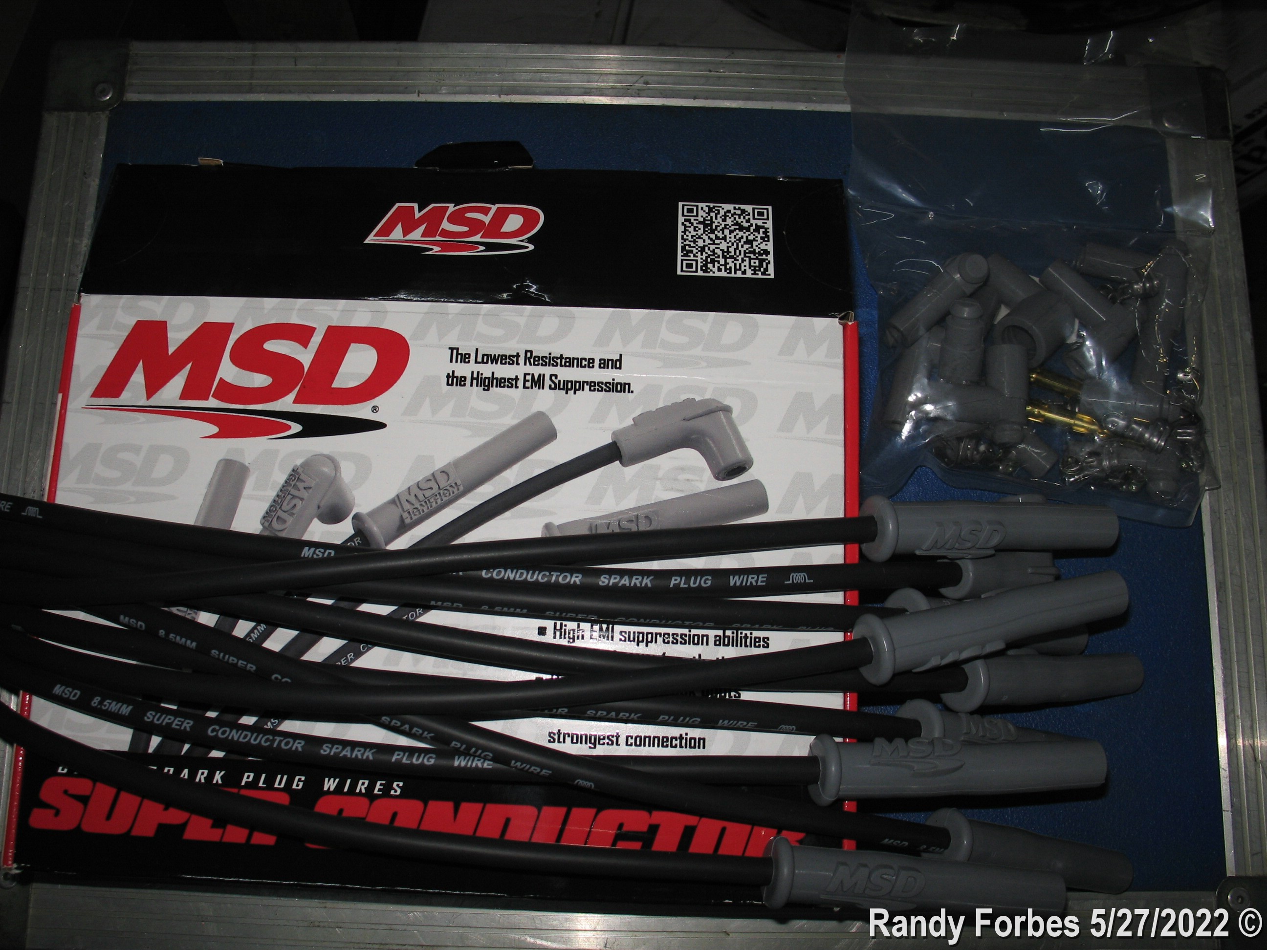

For the wire sets I make up, I use what the hot rod guys have and cut them to the length I want, crimping on High the Quality terminals myself.
I think that is what i need, some kind of clip to attach to the end of the wire before i insert it into the distributor cap. Is there a clip like that and a source for it ? i will do some looking on the internet for a clip like this.
