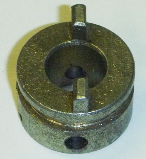

I assume that the distributerpeg in these versions is mounted 180 degrees wrong. Is that correct?

The dog teeth are offset. You could drive out the pin and rotate the dog 180 degrees.
:iagree:- Steve---Just might be what some PO did and got it back on wrong.
If it's 180 out, just pull & turn the gear as Marvin suggests. That's a lot easier than removing the pin and rotating the dog on the bottom of the dizzy and accomplishes the same thing.
