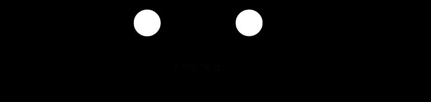

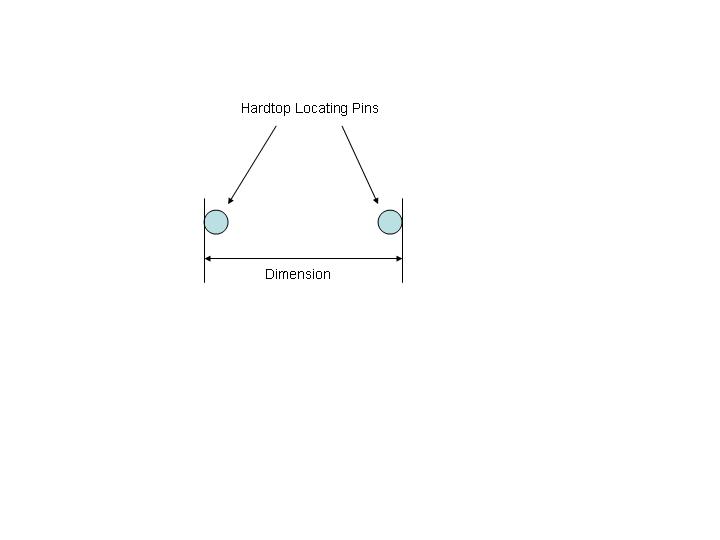

I have two original factory unrestored hardtops. My 2-seater top (serial number starting with a 6), has a dimension of exactly 49” from outside pin to outside pin. My 4-seater top (serial number starting with a 4), has a dimension of 50.25” I cannot measure my BN6 since It is at the paint shop, but I will be able to measure it next week.
Note that the original hardtops were individually fitted to each individual car and the locating pin placement has significant leeway in positioning since it is screwed to the wooden block. I have included several links below that may help a little.
Duane
’58 BN6
One more try on the attachment!
