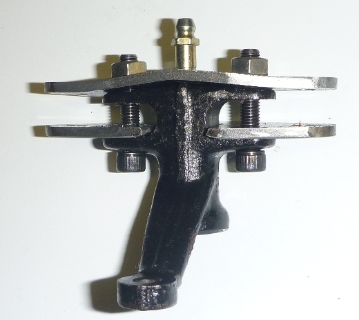

If anyone is installing the Welch (or Cape) rear setup - you will be fabricating your own e-brake rods and cutting and welding the balance lever for increased pull - for which they supply drawings.
PM me if you would like info on building a better linkage using all bolt-on parts.
Picture shows steel extension plates to increase pull on brake rods without modifying balance lever.
Hi Steve
All of us are interested in your(Cape) MOD -easy increase of efficiency to the hand brake was one of my problems - I have just one piece of stainless plate, waiting to copy your (Cape)brackets
