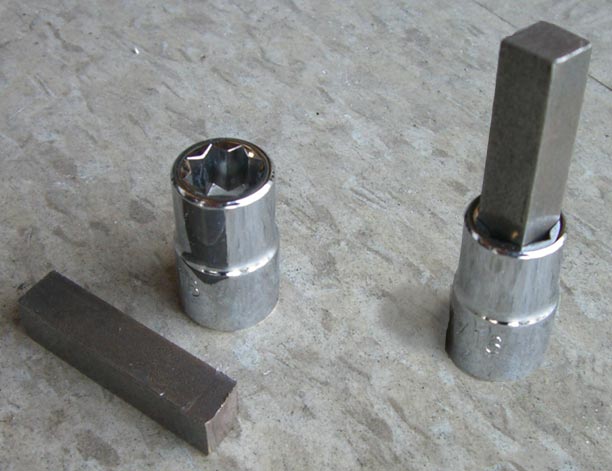

Here's a photo of a simple to make tool for the job. Buy a 8pt socket and a piece of 7/16" stock. My local hardware store carries both but it's not a Hm Depot.

Don't understand why cracking one side of the plug means you can't wrench on it, but I've had success using a 3/8" air impact wrench to remove stubborn screws and bolts.

IMHO this is the way to go - since you only have to do this every few decades. Once you get the 7/16" stock per Patrick above the rest is easy. Piece of cake!
If you can't find the 7/16" stock locally, here you can buy a piece of it online for just over $5:

I agree with Derek. If the plug is buggered you may only get one more shot at removal before you have to resort to extreme measures like axle removal or drilling the plug (which basically means you'll have to disassemble the rear axle to make sure all the swarf has been removed). I'd remove the Panhard bar and fashion the tool made out of bar stock that Patrick has pictured. Heat the area around the plug with a Mapp torch from the outside and using a long breaker bar on the socket tool try to get the bar stock as straight as possible in the plug and hope for the best.
