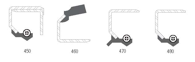

The pinion seal is a 15142 and the rear wheel seals are 17386. Those are CR / SKF part numbers which any bearing shop can cross reference to the particular brand that they carry.
Pinion Seal
SKF Part # 15142
National / Timken Part # 51098
1.500” Shaft
2.502” Bore
2.508” OD
0.311” Width
Style 480
Material: Nitrile
Rear Wheel Seal
SKF Part # 17386
National / Timken Part # 450494
1.750” Shaft
2.502” Bore
2.508” OD
0.311” Width
Style 450
Material: Nitrile
