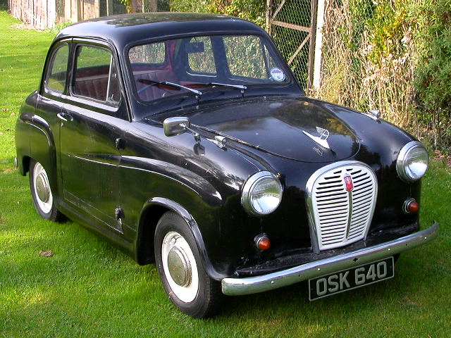

Front suspension and rear axle came from the Austin A35. Pic is from Wikipedia.

Oddly enough, I own both an Austin A35 saloon and a bugeye Sprite. The rear axle housings are identical to my eye and the wheelbase is the same. One of the things that led me to buy the A35 was its place in bugeye history as the donor of the powertrain and suspension. I figured that all the bugeye bits I had rotting on the shelves would bolt right onto the A35. Such was the case.
My A35 now has spridget disc brakes, a 1275 motor with ribcase trans.
The one major problematic difference is when you try to fit spridget headers to the A35. The spridget header angles out to the side to exit outboard of the rail while the A35 exhaust drops straight down to exit right next to the motor. This forced me to weld up my own header for the A35.
