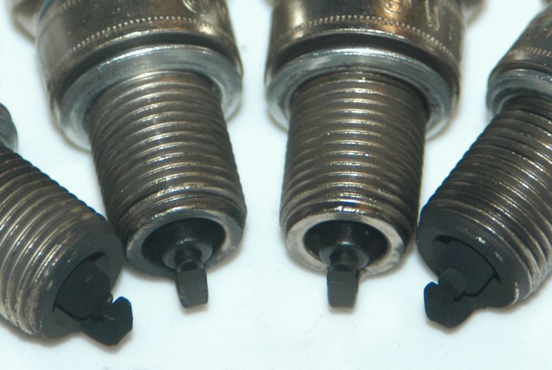

I'm still resurrecting a 78 Spitfire and now that I have the engine running (most of the time) I need help diagnosing it's condition. I'm getting black smoke in the exhaust all the time it's running. It seems to come out in puffs so I guess it could be related to one cylinder but I can't really tell. I'm trying to get a reading on the condition of the engine. It also idles rough.
I've attached a photo of the plugs. I installed new plugs then ran the engine about 10 minutes at about 1,000 rpm. The plugs in the picture are in order: cylinder 1 is on the left then 2,3, and 4.

Jim,
what do you have for an ignition system? what color is your spark? Looks kinda rich. Is your choke working? what kind of condition is the carb in? Compression looks good.

I agree. First, make sure the ignition is in tip top shape. Then I would definatly make sure the choke is opening all the way and that the carb is trimmed right.
If it was puffing blue smoke, then you'd be looking at oil. But you have black smoke, that's a rich condition, or partially unburnt fuel from an ignition problem (either way it's gas, not oil). From the looks of the plugs #3 isen't doing much at all (#1 and #4 look kinda sooty, or, rich). Is #3 damp when you pull it out? You may have a bad wire, or a cracked dizzy cap.

1st and 4th ( especially) plug look very rich.

I checked out a couple of the suggestions this weekend. The water choke was way out of adjustment creating the righ mixture. After adjusting it I'm only getting a little smoke on acceleration. I misted the plug wires while the car was running but found no arcs. Still haven't had a chance to check the spark color.
