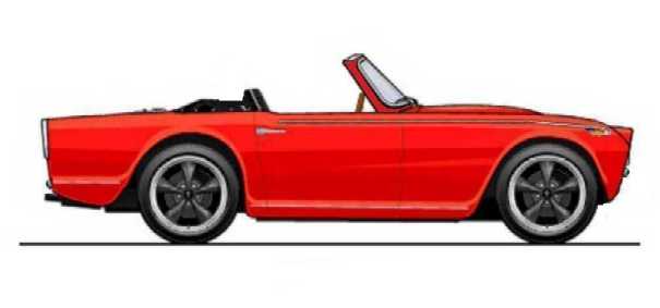

[ QUOTE ]
Ray,
Do you have current pictures of your car with the Bullitt wheels fitted?
[/ QUOTE ]
OK, let's try this again - here's an artist's rendering of my car with the Bullitt wheels:
