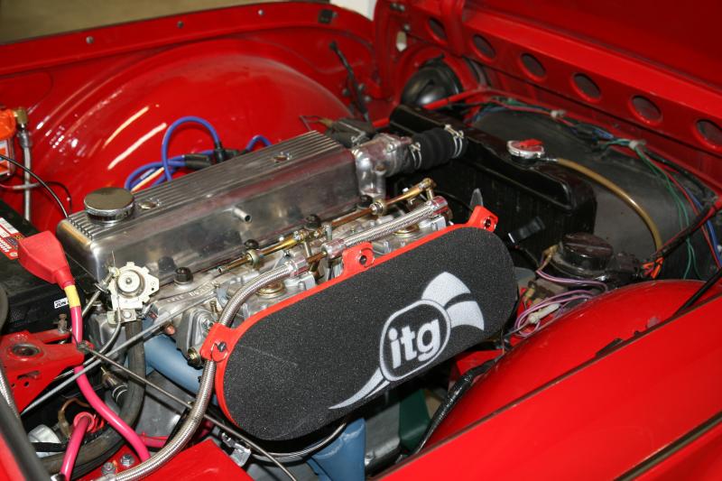

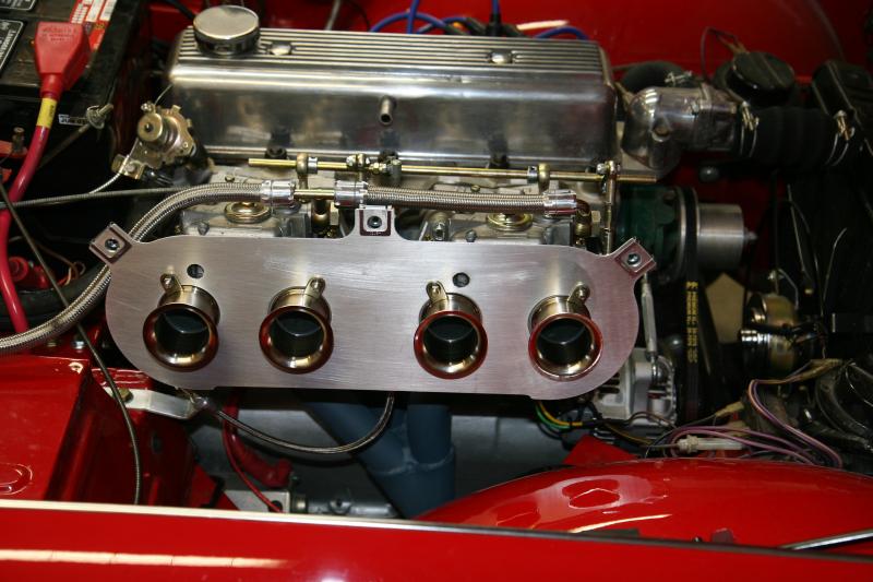

This was what I used when I was running Webers.
Normally I'm not a big fan of foam filters but the ITG filter is nice set up. As for the K&N air filters, I'm not sure what thickness can be run on TR4/4A from a body clearance standpoint. I do know that on a TR250/5/6, that the 2 1/2" is too thick unless you want to start altering body work.
First question is which DCOEs (40 or 45) do you plan on running? If it is the 40s, then use the filter for the 45s. The opening for the stacks on the K&N 40DCOE backplate is too small for any sort of stack. If you run the 45 DCOE filter on a 40DCOE you do not have to open up the hole in the backplate. For the 45s, the 48DCOE filter probably offers up clearance for the stack or at the very least reduces the amount of material you need to remove to fit the stack.
APT offers a 16mm stack for both 40 and 45DCOEs which work with the short K&N filters needed for the TR250/5/6 applications:
https://aptfast.com/ShowItem/102460 16mm Tall Weber 40mm DCOE Ram Stack.aspx
https://aptfast.com/ShowItem/102463 16mm Tall DCOE 45 Weber Ram Stack.aspx
You might want to contact them and see what they have to say about K&N filters for DCOE use on the TR4/4A.
