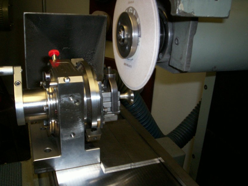

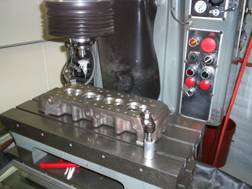

I used a Moore Jig Grinder, normally for grinding holes within .0001" tolerances, to grind the multiple angles on the valve seats. I was able to insure .0002" concentricty and perpendicularity to the bronze valve guides so a valve lap was not needed. I used an old fashioned Fordom hand grinder to polish the intake and exhaust ports to Mr. Vizards recommendations. I used a Mitsui surface grinder and a roto-grind to grind the valves.
Valve grinding
