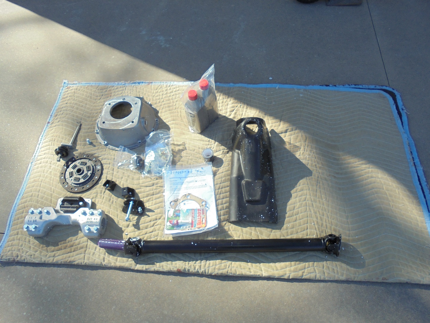

Just out of the box and foam pieces all over, but here's some of it.

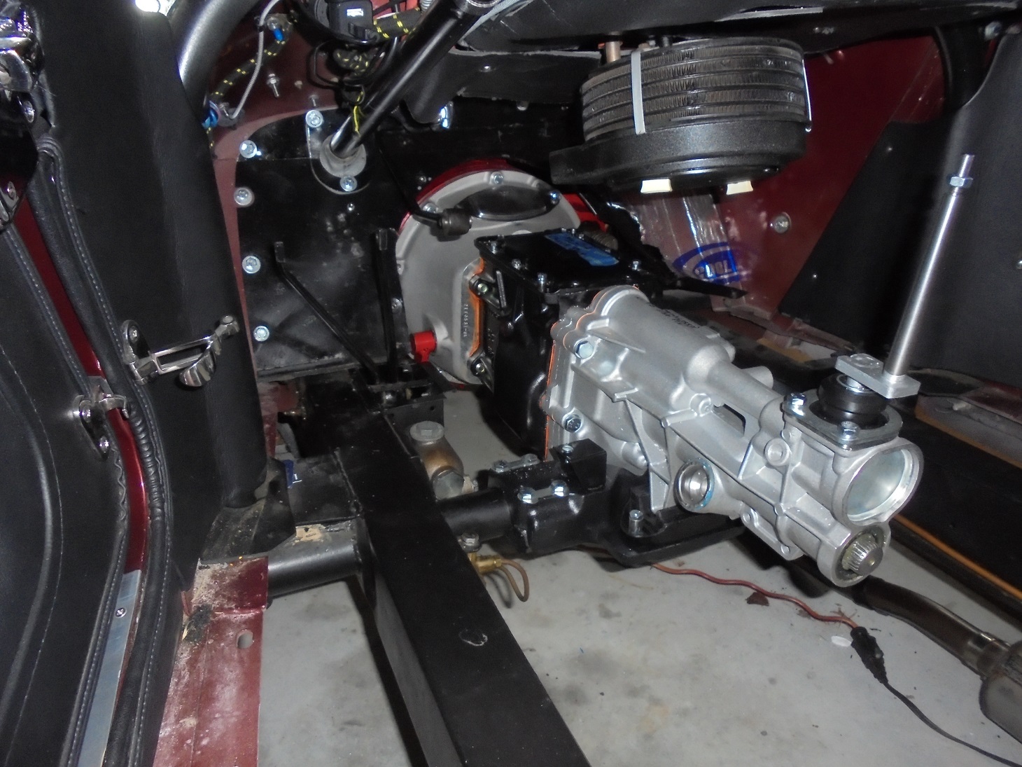

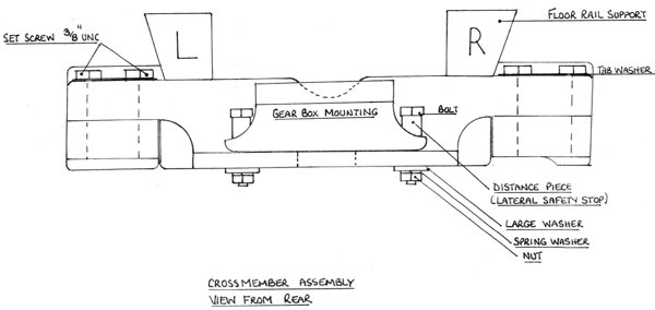

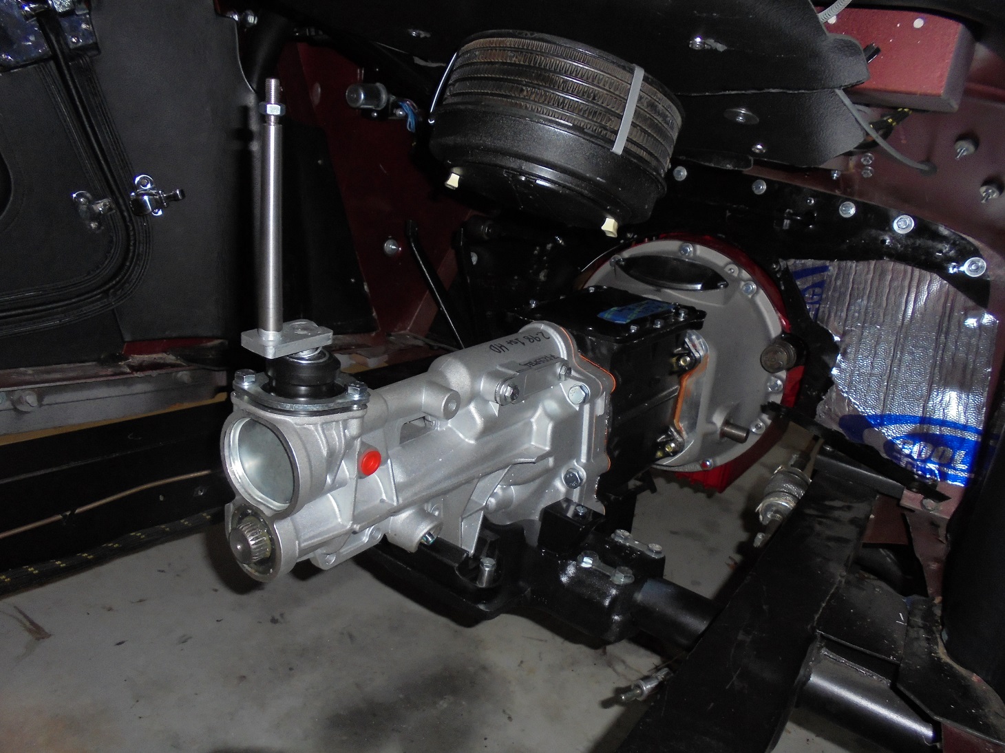

Doc, Here's a shot of Declan's tranny plus a sketch of the modified rear mount. Not being a Datsun tranny, Most info now is on the "My new 5-speed" thread.
