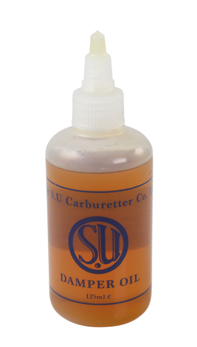

I have HD8 carbs. What is the proper/appropriate dashpot oil?
I believe the SU dashpot oil is 20W. Is it non detergent? (About $16.00 +)

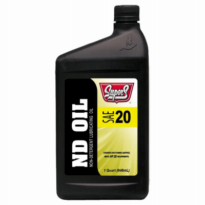

TrueValue sells a brand called Super S. SAE20 Non-Detergent motor oil, Qt. (About $8.00)
Should the 20w be detergent or non-detergent?

When I got My '65 3000 back from the resto, I was told any 20w or ATF or Dashpot oil. I use the dashpot oil because it's apparent the tiny bottle will last years. 5 so far as it only takes a dribble at the beginning of driving season.
I had my SU’s rebushed by a Thomas Bryant who knows his stuff. He recommends using Mobile 1 15W50 oil in the dash pots. I followed his advice.
I have used the damper oil sold by Moss for the past ten years and have never had any issues. The little bottle of SU oil will last a long time. I think there's about 1/3 of the bottle left. PJ
I've tried them all over the decades, and don't recall much of a difference. The oil is there mostly to prevent a rapid rise of the pistons when you floor it, so as to create more vacuum over the throat bridge to offset wall-wetting (and, presumably, to damp piston motion). When oil is low you'll get a slight stumble on acceleration; I suppose 20W-50 may give a slightly richer mixture.
I use the SU bottled oil, mostly for the convenience. On long road trips, I kept a little can of 3-in-1 oil by my seat to top up the carbs every couple thousand miles. Detergent or not shouldn't make any difference, the oil shouldn't be getting contaminated.

Most British car owner manuals from back in the dark ages recommend using the same viscosity oil as was being recommended for the crankcase. I personally find nothing wrong with using SU Damper Oil. I have just replaced the first bottle which lasted me only 45 years,
