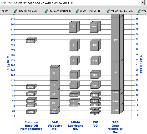

See if this helps explain the "W" designation on oils.
https://www.upmpg.com/tech_articles/motoroil_viscosity/
A 20W oil would have it's viscosity rated at a low temperature.
A 20 oil would have it's viscosity rated at 100 degrees C.
A 20W-50 oil would have a viscosity rating of 20 wt oil at low temperature & a viscosity rating of 50 wt oil at 100 degrees C.
The attached chart should help visualize the differences.
A 10W oil would have a viscosity of about 25 cST at 40 C & about 5 cST at 100C.
A 20W-50 oil would have a viscosity of about 50 cST at 40 C & 18 cST at 100C.
As an aside, you can also see how the various gear oils relate to motor oil viscosities.
Since the carbs are relatively cold, the lower temperature ratings would be closer to the actual damper conditions.

Dave,
As usual, you are a walking library of information. I will save
that chart that you have provided. What I am trying to do is find out what the 3-1 and sewing machine oils were in viscosity so I can attempt rank all of them in increasing order of viscosity. I didn't realize that motorcycle fork oil came in so many different viscosities but I guess it should not surprise me. Which type of ATF fluid is 5-20 ? Ford, dextron III, Chrysler ?
