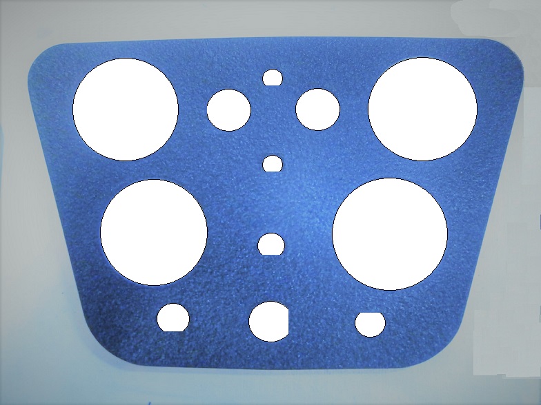

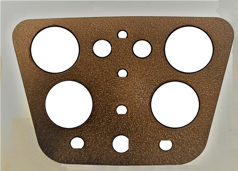

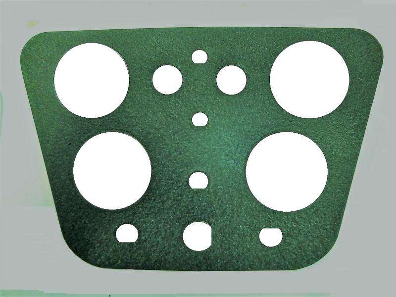

I favor the VHT Wrinkle rattle can for my restorations. It only comes in 4 colors
but I discovered a trick to finish it in any color. Do the wrinkle in black or
gray, then, when it is fully cured, spray the finished product in a light coat
of enamel in whatever color you choose. I did a Morgan plus four panel in
black, then dark brown. So close to factory no one could tell.
