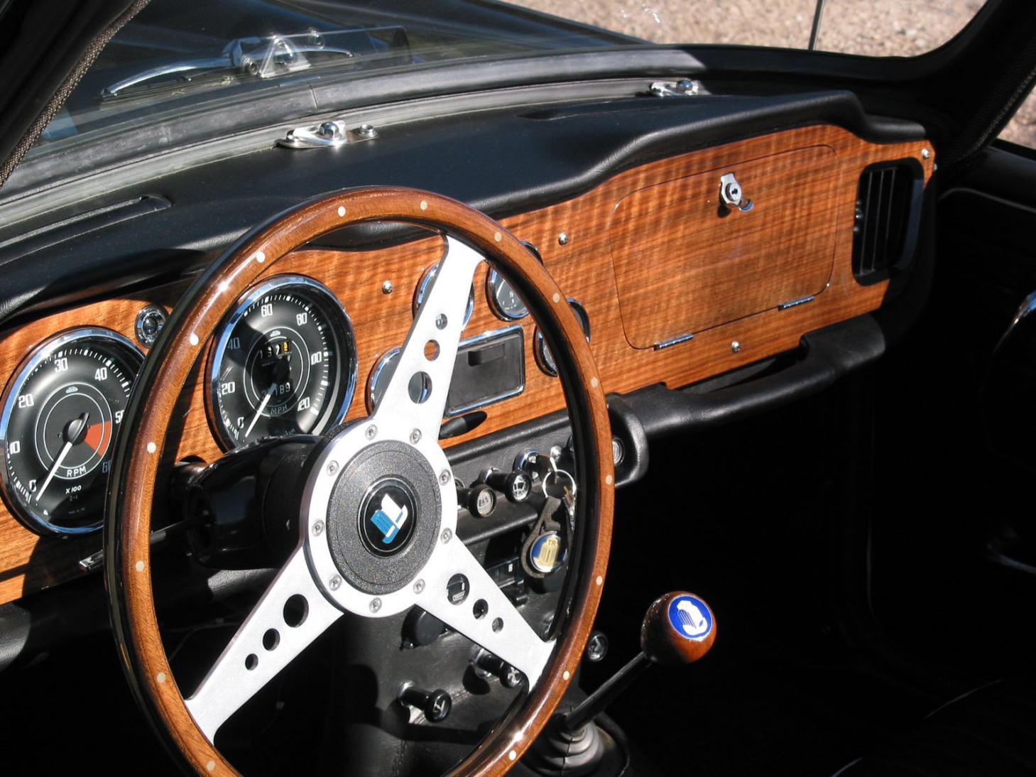

Geo makes a good point. Frame and glass together. In hindsight, I should've ordered new glass. Mine is a bit pitted. Style, grain, etc. is personal, but here's what I did for the dash:
