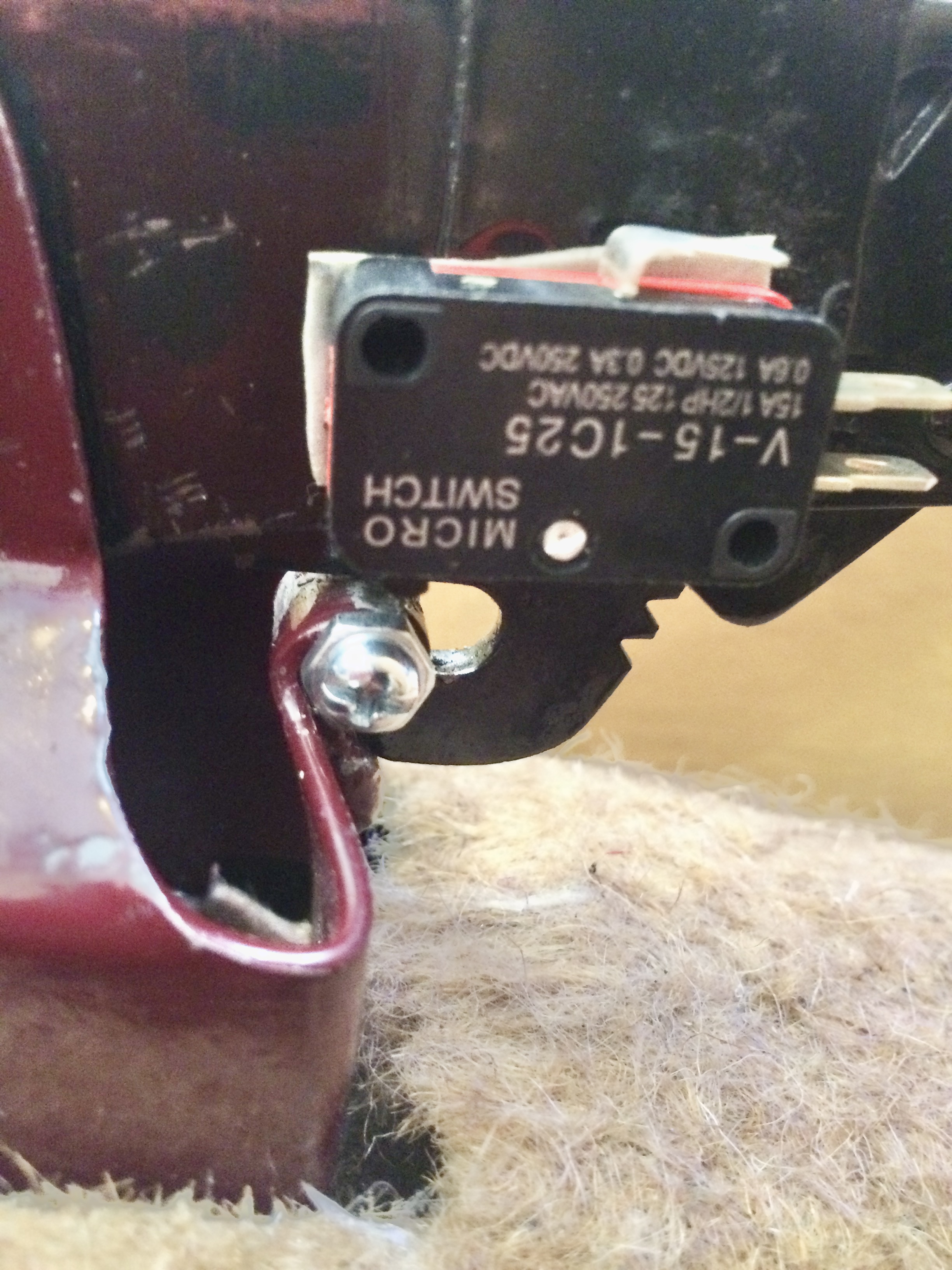

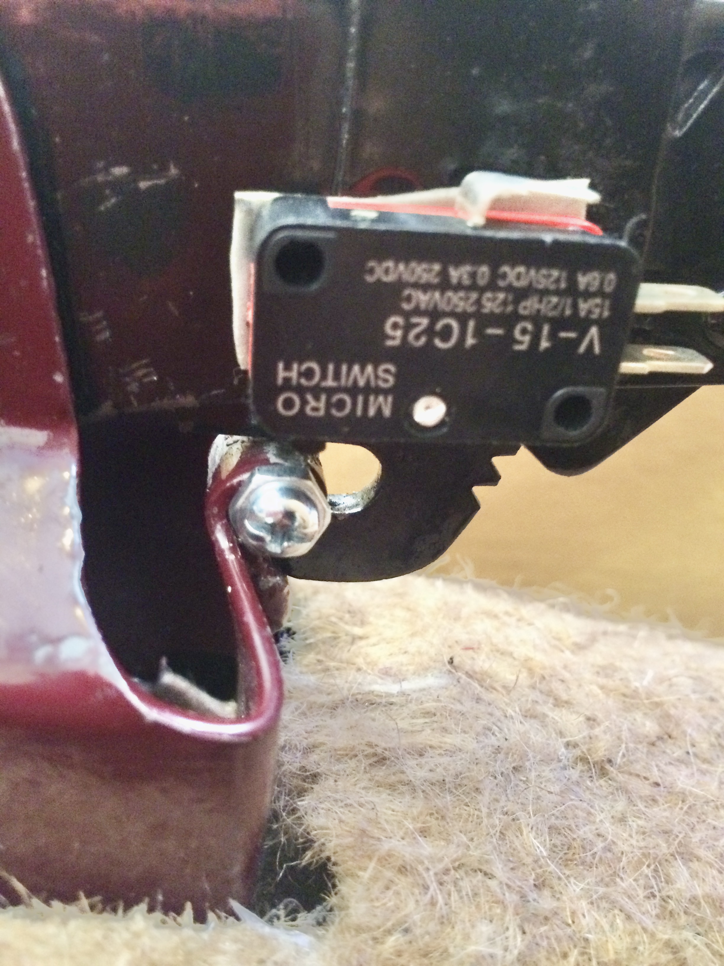

I used a micro switch like this mounted to the brake handle and wired into the dash brake light on my TR6.
Good idea. How is the switch held to the ratchet part of the handbrake?
I used two-sided foam tape and it’s held up well. I also added a screw and spacer nut that the switch makes contact with when lowered.
In your photo what is the L shape prong on the switch connected to?
The L-shaped prong is the connection for the switch. It’s NO and goes to NC when the handbrake is lowered. +12v to switch, then I wired it to the brake light on my dash.
