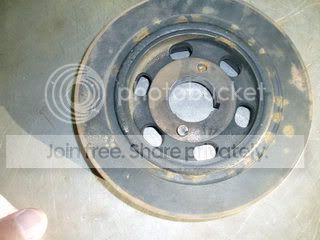

This is my damper. Machine shop recommends rebuild.
$150.
Thought I read a thread that said the new replacement
parts do not have the timing marks, making rebuild
more attractive. Haven't compared prices.
Curious. What's involved in rebuild? Looks, at first,
like a new rubber. Does this rubber push in a groove?
Is it one piece front to back? What do you think about
its condition from the photos?

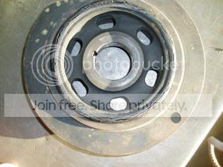

and
and hardly know why...but, then, why not this shot --

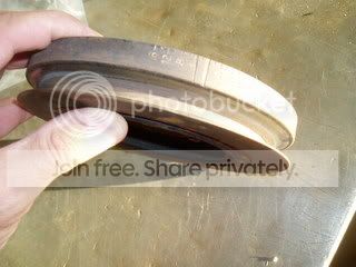

Oh, actually, this last shot because I was curious
as to the timing marks. Looks like somebody scratched
in their own mark or something....no?

Mine has no numbers on it. I have one etched
line clear across and one line halfway across.

795 - Is the aforementioned rubber crunchy? Can you break pieces off with your fingers? With a screwdriver? If so you should look into a professional opinion, and potential rebuild. Judging from the photos above, that damper needs rebuilt.

Forego the dissertation, Jer. You're right. The damper pictured is approaching end-of-life. The cracks around the front diameter are a good enough indicator. The rubber has lost compliance. When that happens, the "damper" becomes an "amplifier" instead.
Dennis, turn yer head an' cough. Then package that thing up and send it to the guys in Anderson. /bcforum/images/%%GRAEMLIN_URL%%/wink.gif

And I am sure that the dudes at Damper Dudes know what they are doing (I have heard of them before) but what are the chances that they will be able to line up your timing marks with the key hole in the crank perfectly? And if they are off a degree or two, what a mess.
They have th' spec's. Besides, you really think the 'factory' ones are all that accurate?!?! /bcforum/images/%%GRAEMLIN_URL%%/devilgrin.gif

If you have your cylinder head off and can get a dial indicator, you can quickly check your timing mark!
Run cylinder 1 to near TDC and put dial indicator on top of piston.
Go to the highest indicated position, and your timing mark should be at zero.
Some (with more patience and better tools than I) have done this through the plug hole.
IF you do re-mark your damper, be sure to stamp Xs through the old line!

It's always a good idea to check absolute TDC against those damper "suggested TDC" marks, in any case.
FWIW... I had my damper rebuilt by the damper dudes about eight years ago. When I rebuilt the engine I checked TDC #1 to the timing marks on the pulley/damper. They were dead on. The damper dudes are the dudes. Or were at least for me. /bcforum/images/%%GRAEMLIN_URL%%/wink.gif
If you look at what they do, it appears that they know their stuff. I don't think that they'd last to long in the Ford/Chevy HP forums if they didn't get the marks dead on for some guys 427 engine.
