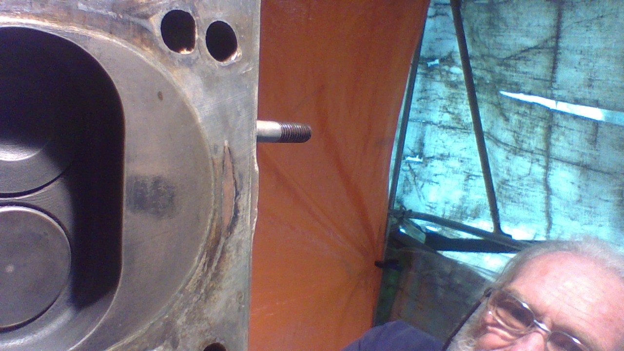

Getting ready to take the head to a machine shop.I am taking the valves out tomorow for inspection. I noticed above the 2nd cylinder
the metal seems to be worn thru. Also a black spot in that area? This is only above the 2nd cylinder no where else. Any ideas on what would cause this and how serious is it?
Getting ready to take the head to a machine shop.I am taking the valves out tomorow for inspection. I noticed above the 2nd cylinderView attachment 98261 the metal seems to be worn thru. Also a black spot in that area? This is only above the 2nd cylinder no where else. Any ideas on what would cause this and how serious is it?
Did you inspect the old gasket, for any issues?
Ya found the problem Karl,now you have to decide how far to go into the motor to "make it right".

My guess would be gasket breaking down in that area and the black spot is in relation to this.
Head shop should only skim enough to sort historical issues like this.
Replace with a good (soft - annealed) copper or composite gasket

I've been wondering about how much the machine shop would skim off? I know that the block measures 3.330". I don't know how much has already been taken off the head? This whole issue is new to me. I assume a good head shop would just take off the bare minimum to make it flat. I don't necessarily want to raise compression if it is going to cause other problems. Here are some quotes from a previous discussion on this that I came across: "many have run .070" with no problems" one guy ran "090" for 40 years" "head gasket failure led to .103" off" So at what point can no more material be taken off. A good machinist should know what it is best but are they all familiar with old school 60 year old Brit cylinder heads to make an informed decision?
I think the machinist will take off the minimum and if I remember correct 3.3 is the original thickness. I will measure one this week. The original head thickness measurement should be in the large owner manual

Yes it is 3.3. Thanks While we are on the subject I am a little confused about the cylinder liner height above the block. I believe it is .004". I am going to measure the height again. What if the height is above .004 say .006 would that cause problems? What if a liner is .002 on one side and .004 on the other side? So when I put the straight edge on the block a .004 gauge should go under but anything above or below that is a problem?

Bob Shaller aka TR3 driver a well know TR3 guru who is no longer with us had a trick he used for problematic head gasket sealing...."Where the liners don't stand up far enough solder a ring of 26 AWG bare copper wire around each cylinder just outside of the folded edge of the head gasket." He states that he did this every time he had this type of problem and never had a head gasket failure on any TR3 after he started doing this. Do you see any problem in me trying this with a new head gasket? Also where to buy the best composite head gasket for 83 mm cylinders. I've seen some improved types but they look like they are just for 87/89 cylinders?
I would get a copper head gasket from either Moss or BPNW. Sure I bet the wire idea would work; it is basically smashing more copper in the liner area. I would was the copper wire trick in a pinch.
