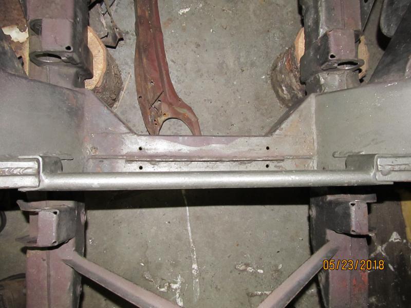

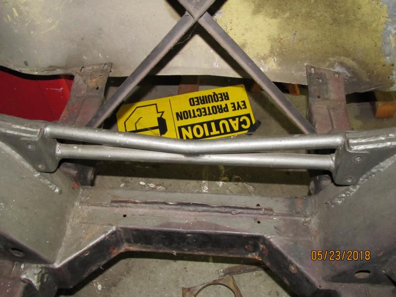

Hello,
I'm heading down the path of restoring my dad's BT7. I'm planning a 'fast road plus' engine build (basically one notch below full race) and plan to use the Denis Welch super damper on the crank. Two questions:
1) Any feedback on the Super Damper (I've seen several endorsements here)
2) Can someone who has installed this part give me some detailed instructions on the crossmember modification required?
The car is on the rotisserie now so I'd like to get all the frame modification instructions to the shop this week.
I found this image: https://www.ahexp.com/phorum/file.php?8,file=1346,filename=cutout_for_damper.jpg which is helpful but I'd really like some dimensions if anyone has them.

I have installed one on my BJ7 and the cross member does not need altering.
When you install it would help to warm it up, I think that the instructions tell you to do that anyway. I boiled mine but you can use a hot air gun and warm it up that way.

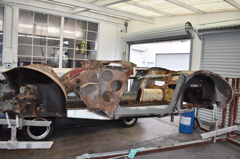

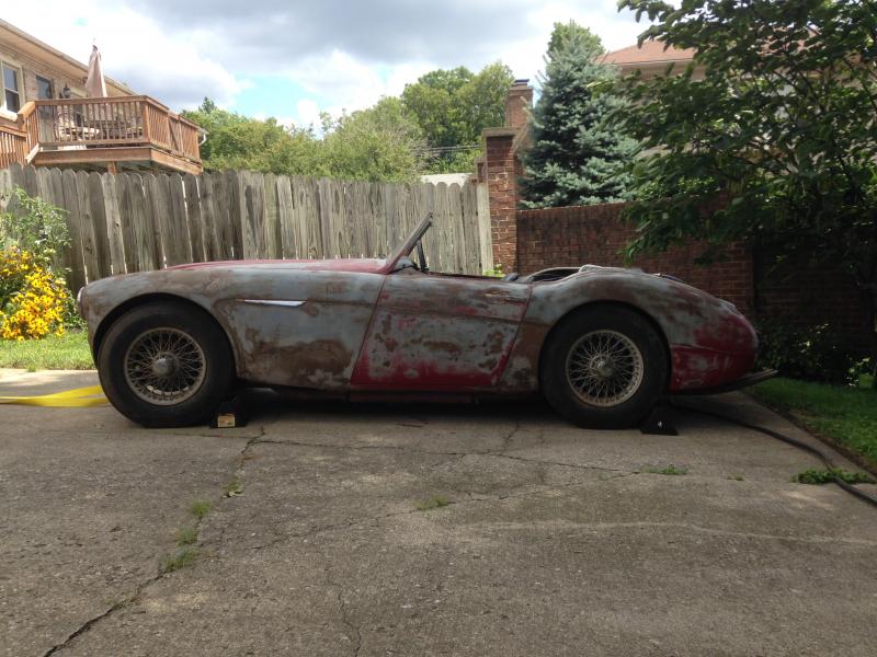

Here are a couple of images of the car, for everyone's amusement. The first is the car parked at my parents house, as it was when I took delivery from my dad (after sitting in his garage for 40 years). The second is a picture of the car as it is today. Sometimes you have to go back to move forward....
Hi Rob, If you are going to modify the crossmember, I suggest you consider making a removable one instead. Cut off the original one just inboard of the radiator mounting holes, weld caps across the open ends and make a replacement offset to the front to give more clearance for the damper. The other advantage is that you can now open up/work on the front of the motor without having to disconnect things and jack it up. This is a common modification for racers, as it allows changing cam & cam timing in situ as well as replacing seals, gaskets, timing chain, etc.
Dave
