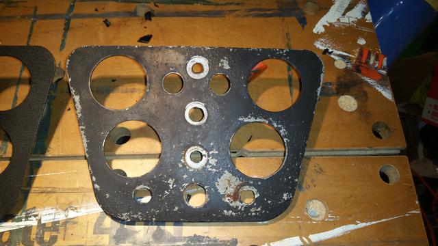

After removing all my gauges, switches and instrument lights from the center panel, I took it down to the shop (a short walk down hill, longer coming back up hill) and stripped the old paint off with a wire brush on a mandrel. Quick work 5-10 minutes using a coarse, then fine wire wheel to leave a fairly smooth paint free finish. I took it back up the hill in the cold and downstairs to my work bench in the basement. My basement is heated and I often spraypaint model rockets or crafts since the temp down there is consistent all year long. I pulled out some primer and shook it up and started painting.
Mistake 1: metal parts also need to be at the right temperature for paint to stick. I didn't get a picture (too embarrassed then to share) but where the paint did stick it drew the paint away from where the paint didn't stick. In effect, it looked like Swiss cheese. I allowed the paint to "dry" and attempted a second coat a few hours later. Mistake 1 now was even worse looking as it looked more like craters. Let it dry some more and attempted to sand it.

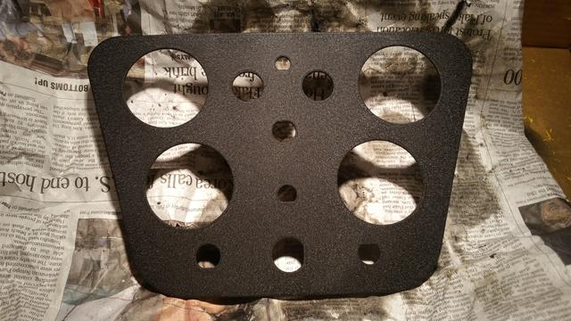

Finally, I decide to experiment. I now know that my horizontal lines are where the paint wasn't heavy enough because my passes didn't overlap enough to keep the paint thick enough to create the wrinkles. This time I layer the paint heavier on my shiny spots first, and then another overall coat to make it even. Tired of waiting, I "help" the drying process by turning my heat gun on it (lower of two settings) and keep moving in circles from the center. My thick crinkle paint then does something amazing, it starts to wrinkle and in the light, I can see it (the crinkle/wrinkle) spreading outward slowly. I move in with the gun a bit and watch it accelerate. It's still shiny, but I keep passing the gun over the panel slowly and watch as the finish becomes more matte and even. Woohoo! Now I just need to cure it. I go to pick up my part (by the edges) to transfer to a metal tray/baking dish (like you see in the salad bar) so I can cook my part. The part is hot and slips, but guess what? NO DAMAGE! In fact, because the part was heated so much, my supposition is that it is cured. I test this (after the part has cooled) by trying to scrape some of the paint with my fingernail (next to one of the indicator light holes) then finally with a small screwdriver. I do score it a bit (it will never show) but I pronounce it cured.
Yes, yes, I'll get to the pictures (eventually). It snowed today, so instead of working on recovering my dashboard, I had to run the snowblower over Dad's, my brother's, and my driveways. We are all neighbors and there is perhaps a half-mile of driveway (my brother and I share one long one) between the three houses. My Dad's is steep (his house is on the side of our hill below my brother and I) and despite 6 forward speeds and 2 reverse, it's a lot of work. My Dad isn't a very young man and just had eye surgery, and my brother had surgery as well (about 6 weeks ago). I actually like doing it, and since they are my two best friends as well it's no big deal to me. I'm not a very buff guy and workouts like that really can wear me out. Either way, Mom fed me (she always wants to feed me) and Dad and I catch up on our TR projects while we eat. He started his center panel and got stuck on these two knobs and I volunteered to take over. I'm getting good at this, remember?

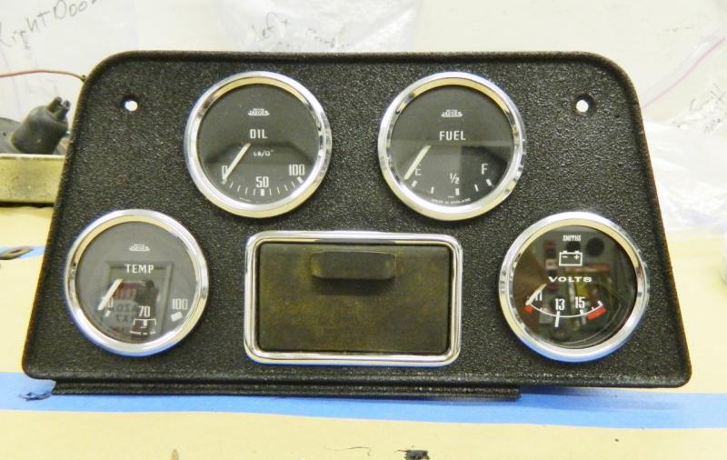

The two knobs didn't survive (we kind of knew they wouldn't) but the switches did and I took everything I learned so far and applied it. 5 minutes on the wire wheel, up to the house, clean first with windex, then with alcohol, hit it with the heat gun, check temp, level, spray one heavy even coat using three directions, let stand 3 minutes, then I turned on the heat gun and helped it dry. I continued with the heat after the wrinkle/crinkle appeared until the shininess disappeared. I can't wait to show him! On top is the before, please note there was some rust-like stains in the metal after the wire brush. I used an 80 grit sanding wheel on a Dremel to touch those up.
