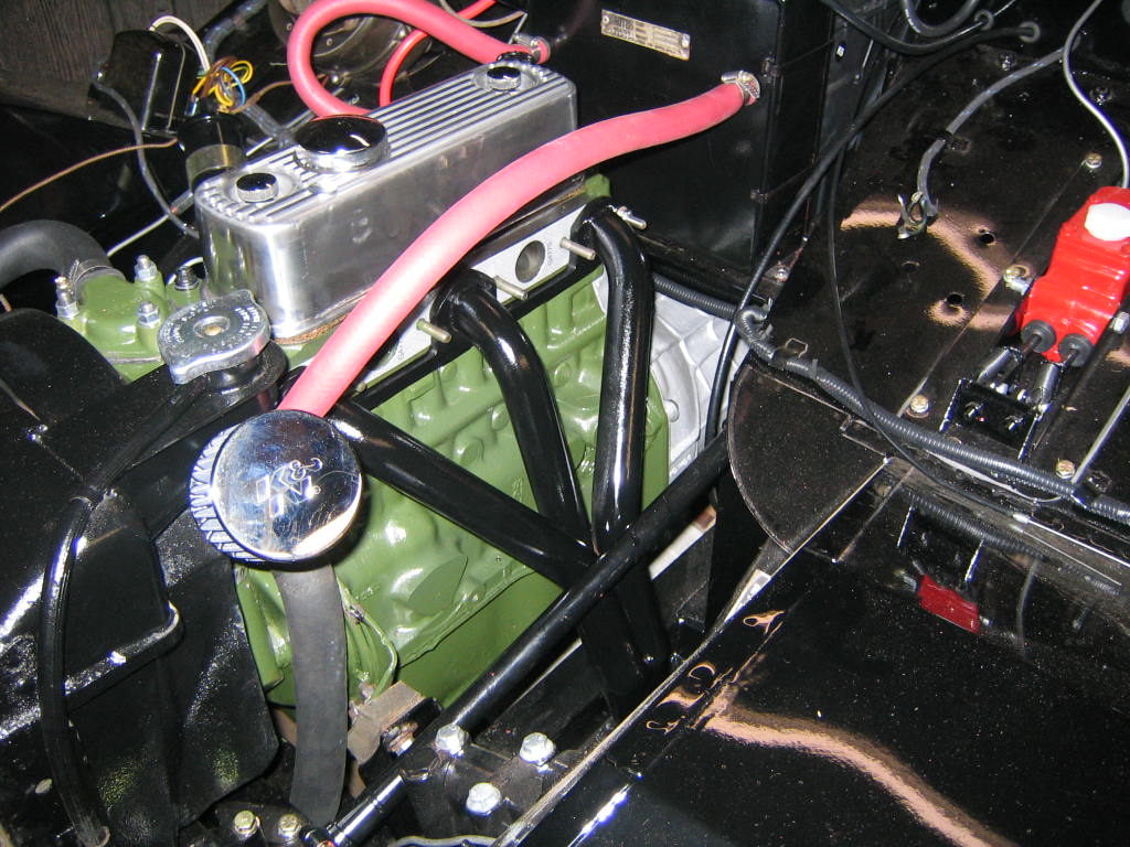

I ran a 5/8 hose from the separator to a 5/8 pipe that slides very tightly into the K&N filter. I currently have it tied to the lower radiator hose. (Don't know if I really like the mounting?) I will probably reroute the filter someday.

Like Jeff, I've never seen the breathers plugged. However, I have some friends who have picked out the old metal gauze that's in the canister and replaced it with a stainless steel "Chore Boy" scouring pad.
