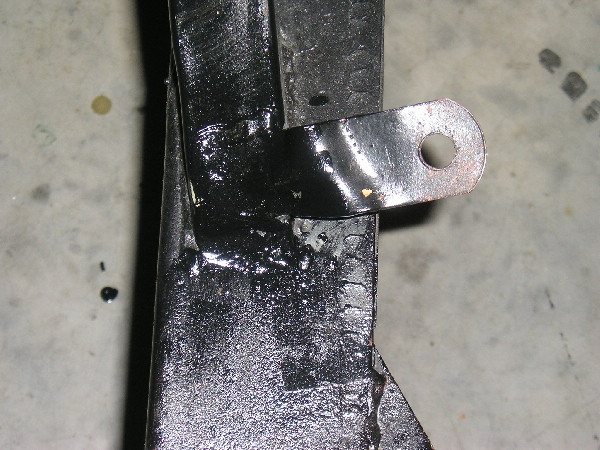

There is a metal tab on the driver side of the frame on my TR3A at the front portion of the frame just before the tower support. I have attached a picture of it. It is bent and I'm wondering if it should be bent or straight? I have attached a picture of it.

that's the tab where the clutch line meets the hose. the threaded end of the flex hose goes through the hole and gets captured by a nut, then the steel line screws on to it. It just needs to be oriented so it dosen't kink the lines that run through it. I think they usually have a bit of a shape to them. not totally flat.
