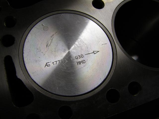

On my TR230 motor the pistons had little triangles stamped into them, my machine shop guy said they were arrows pointing towards the front.

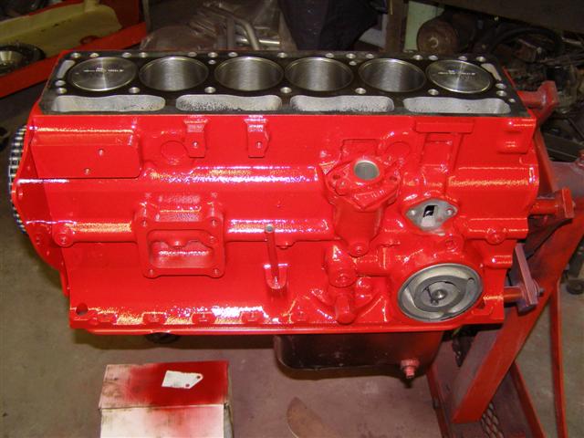

These pictures show the way for the triangles or arrows, but I don't have any of the rods fitted to the crankshaft.

Yes sorry, tr250, on that motor the arrows point towards the front, I got the impression from my machine shop guy that was fairly standard, but I would get better information than that before making a final decision.
