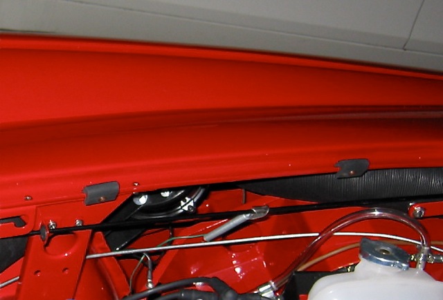

Hey all,
Quick question on the rubber buffers that mount to
cushion the hood. They come with both sides equal
length but to sit square on the edge around the
shroud, it seems that you need to cut the side that
sits on the shroud and leave the other leg stock
length. Is this correct ? Otherwise if you don't
cut one leg, they will not sit straight on the edge.
Recommendations,etc !
Thanks,
Mike
The correct ones already have unequal length sides.
Mine must not be *correct* because I too had to trim one side slightly shorter to fit right.
In practice, they work fine, but man are those rivets a pita to spread!

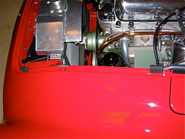

JAV is right. The originals and the correct replacements are unequal lengths.I believe I got mine from British Car Specialists. I used the flat blade of a screwdriver to carefully bend back the prongs of the rivets. The shorter side goes to the outside of the shroud.

Lin;
Wow... nice aluminum radiator you have there....
Did it make a big difference in cooling?
The shroud machine screws were painted by hand after the photos were taken. I did a number of things to help with cooling and the radiator was one of those things. My car actually runs a little too cool. I am looking for a higher temp thermostat (maybe 190) for the winter months.
