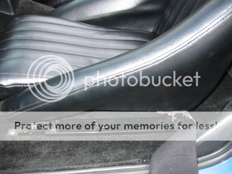

For mounting, I'll probably modify and use www.summitracing.com's dual locking brackets. (Dual locking type are the only adjustable sliders acceptable in some racing venues.)
/ubbthreads/images/graemlins/cheers.gif

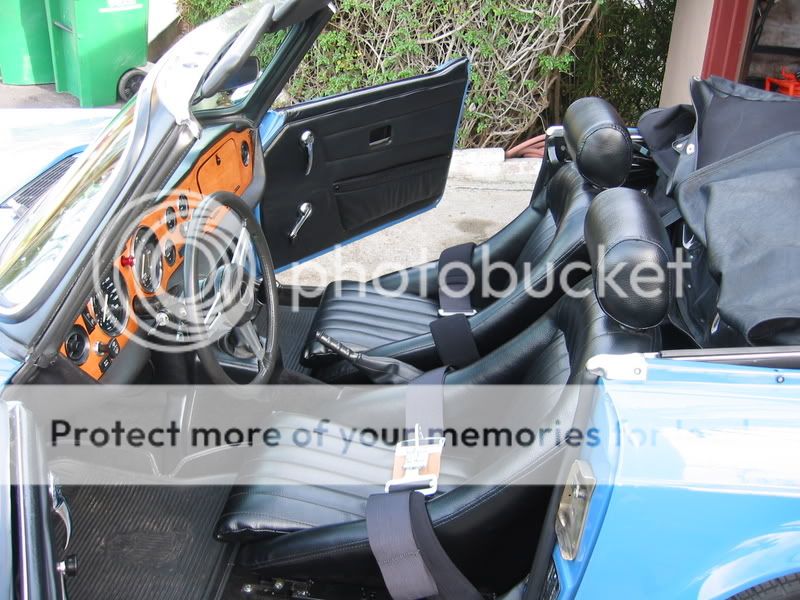

I have ther Classics with headrests in my 4A. It's still a project so I haven't driven in them yet. I used the Corbeau universal sliders mounted on aluminum channel to the floor. Perfect fit for the space. They are very tight fit to sit in so they won't fit everyones body.

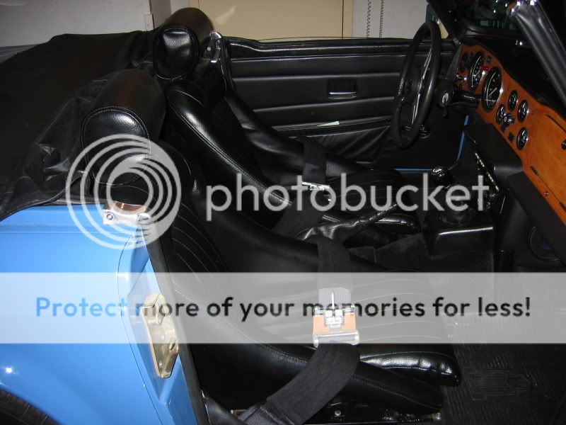

I paid about $225 each with shipping, Plus the cost of the seat tracks.
I modified the seat bottoms by reducing their height by 50%.
I had a shop do that, they took out about 50% of the foam.
I do not know how well they might fit with a roll bar. We had to move the seats inwards to avoid the soft top
mechanical parts. Check out that out!!
Nice idea using the harness pads to protect the seats. I wish these seats had harness slots but I agree, they're great looking seats.
