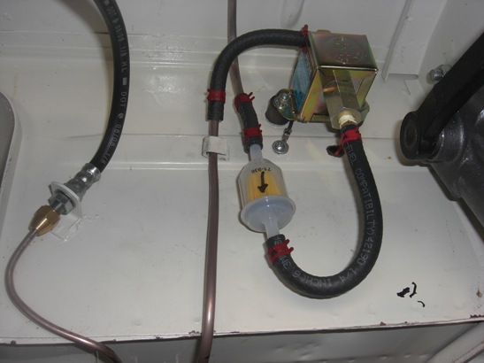

I bought both the 3/16" diameter brake lines and the 1/4" diameter tubes from fedhillusa.com. The tubing material is a copper alloy which is strong, but is fairly easy to bent. Highly recommended! I bought a tubing flair tool from Sears for the brake lines. The picture shows my fuel pump set up with both brake and fuel lines.
