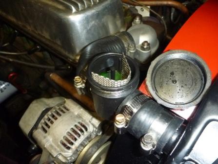

I decided to install a Tefba cooling system filter at least for a while to capture any more rust bits still in the block and have pictures of the flushing results and Tefba install with info on the filter. (No financial interest)

PS - an engineer at Royal Purple told me distilled or ionized purified water is the most aggressive corrosion agent. We should be using tap water or filtered drinking water. The minerals protect the engine.
