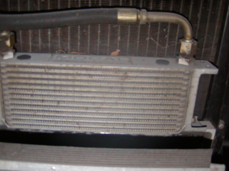

Where would you mount an oil cooler in a Bugeye?
[/ QUOTE ]
Alot of the ones I seen are mountes on the right side of the radiator sitting sitting sideways using the radiator bracket as a mounting point.
Here is mine. Crummy pic with the hood front hinged. And yes, it needs a bath...lol
My oil cooler is mounted in front of my radiator. Works great. My SU's are a little rich and know I need to adjust -- still runs fine @ 60 mph and 80 degree's.
Good call on the oil cooler. Had to sacrifice the vent hole for the oil cooler lines. Water pump is a must -- don't go with the cheapy $40 one -- plastic impeller and if it breaks inside; you won't tell. Go with a all metal one (Winners circle or Peter C) and the probability of it breaking is minimal - metal vs. plastic).
