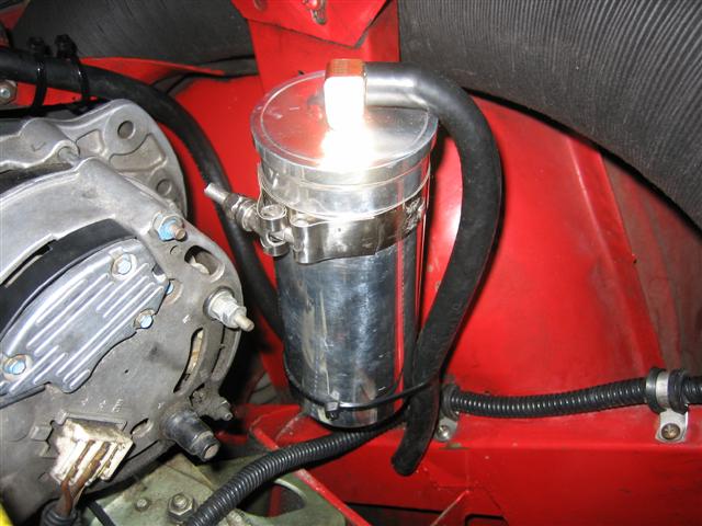

Steve--
I installed an AL expansion/recovery tank as shown in the attached photo. The hose from the radiator runs down and to the bottom of the tank. The other hose runs from the top of the tank toward the floor.
The tank gives the coolant someplace to go other than on the garage floor when it expands, esp. after shutdown and also provides a method to "recover" the coolant into the radiator as it subsequently cools and contracts through the one-way valve in your radiator cap.
As you can see this tank is not pressurized.

Yep Dave, except I use OE caps from the UK. 7 LBS on the radiator and 10 LBS on the bottle---Keoke- /ubbthreads/images/graemlins/yesnod.gif
