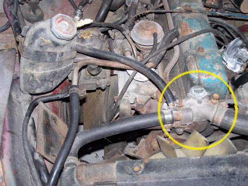

In a photo I took of the engine bay before I started stripping it out (little insurance policy) I can see that the hose from the top right side (when facing the car) goes to the thermostat housing, while the top left side also goes to the thermostat housing. This hose has a T-piece in it which branches off to the overflow bottle. Can't tell where the bottom left hose goes to.
Am I right in this???
Does anyone have a picture or details of a UK spec setup so I can see what the differences are going to be??

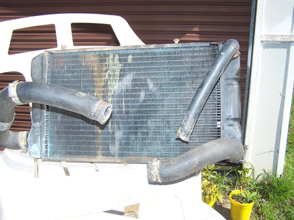

Just an update on my radiator worries. I have been visiting a few posts on this problem, and it appears that the Rabbit and Geo Metro radiator solutions only work for earlier model Spridgets, while my '79 model has three hoses "sprouting" out of it. Went to the local pull-apart but they had never heard of a three hose radiator.
Can anyone enlighten me to how the top two radiator hoses can be attached to the same fitting at the Water Pump??? How does the water move around in that small space to get into the motor for cooling???? Very confusing. Can I actually use a two hose radiator if one of the top hoses just diverts straight to somewhere else in the engine bay and not into the engine.

Back of the radiator. I'm thinking that the thinner hose just goes to the thermostat area and doesn't actually get into the motor somehow, but is diverted straight to the overflow tank.
Unfortunately I can't find an "exploded" view of the thermostat area, and my engine is still at the doctors.
Wazza

Warren, the third hose (bottom left looking at the engine from the front) comes from the water pump which is behind the fan. That is where the water mostly gets moved. you might be able to get the flow from the bottom (water pump line) to the diagonal top.

The two large lower hoses are the main feeds; the left side is the intake and the right side is the return. The smaller hose in the upper right is the bypass for when the thermostat is closed.
