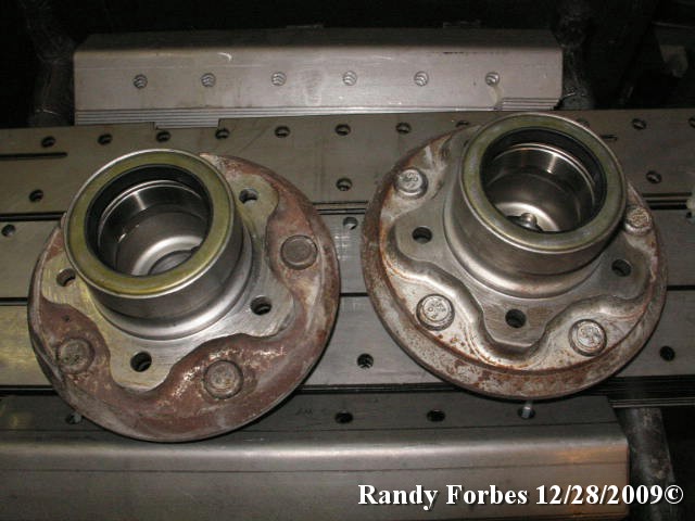

Disc brakes and bolt-on wheels; if you can't find a pair of used 3000 MKI/II hubs (and they're very scarce), you can have them made, like I did...
Not cheap, mind you, but doable.

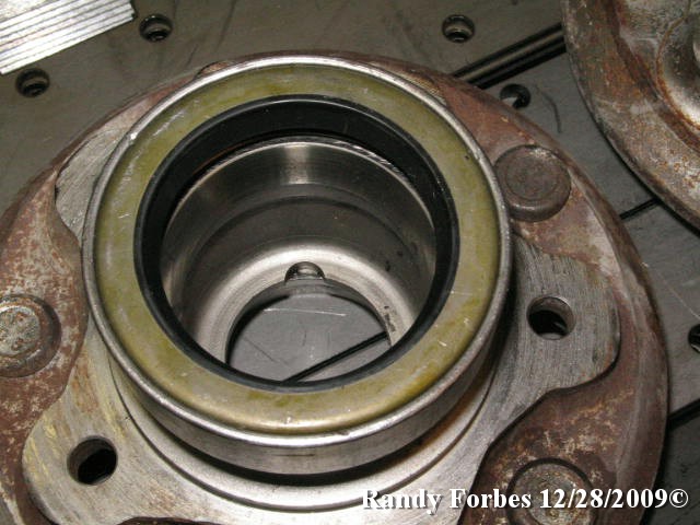

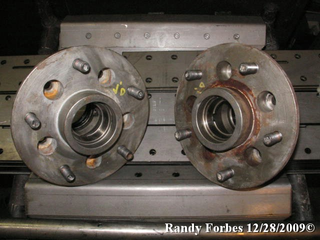

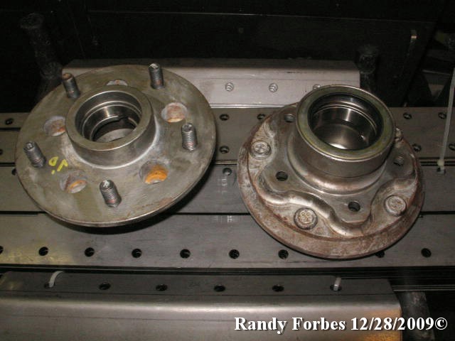

Randy, did you have hubs made from scratch or did you modify an existing hub?
Randy,
Impressive project. Why did you start with a BJ8 hub as a pattern?
Now if you would provide some dimensions for the drawing, I will fire up the LeBlond and the Bridgeport and start making chips.
Very cool hubs!!

They were all out of MKI/II hubs (and that was the lone-dust encrusted box NOS disc wheel hub that Southern Carburettors had back in the mid/late 80s).
I wanted them, and after searching for a couple of years, I commissioned three car-sets to be made.
We just had to use the dimensions for the earlier hubs, to keep the original outer bearing size intact.

While I did all the measuring and dimensioning, I was not the one doing the CNC machine work; I had done some side jobs for that shop (at one point saving them tens of thousands of dollars by "saving" a machine that had been condemned__for a PLC fault, no less) so they were glad to return the favor. It did however, take nearly two (<2) years from start to finish, because of man & machine availability, but what do you want for nothing? ;)
I supplied one set of hubs in exchange for the NOS (BJ8) hub I was given. and I ran a pair on my car for a decade or so, keeping a set as spares. When I decided to put the wire wheels back on, I sold off the spare set of hubs to a member here in the St Louis, MO area. I'll keep the remaining pair for when I change my mind again in a few more years, lol!
