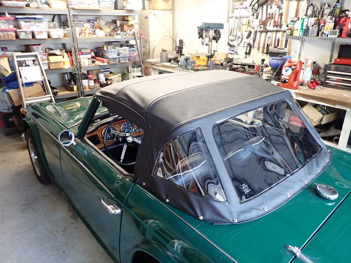

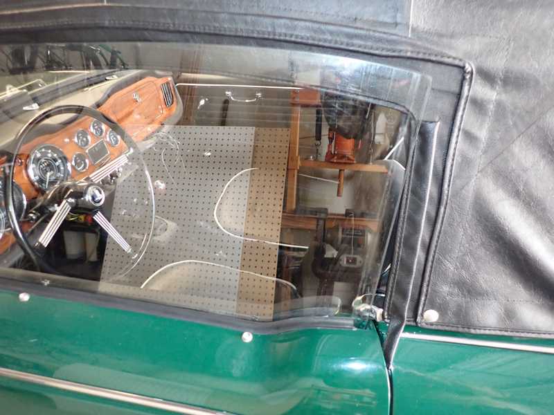

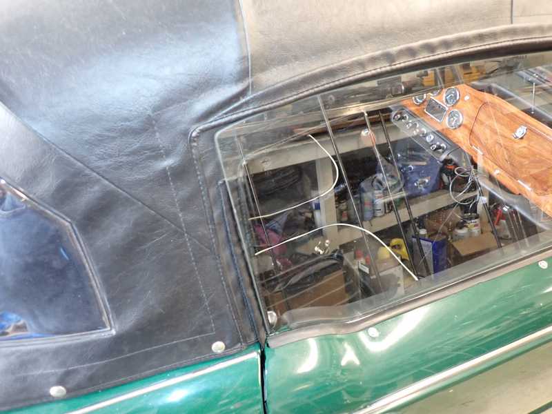

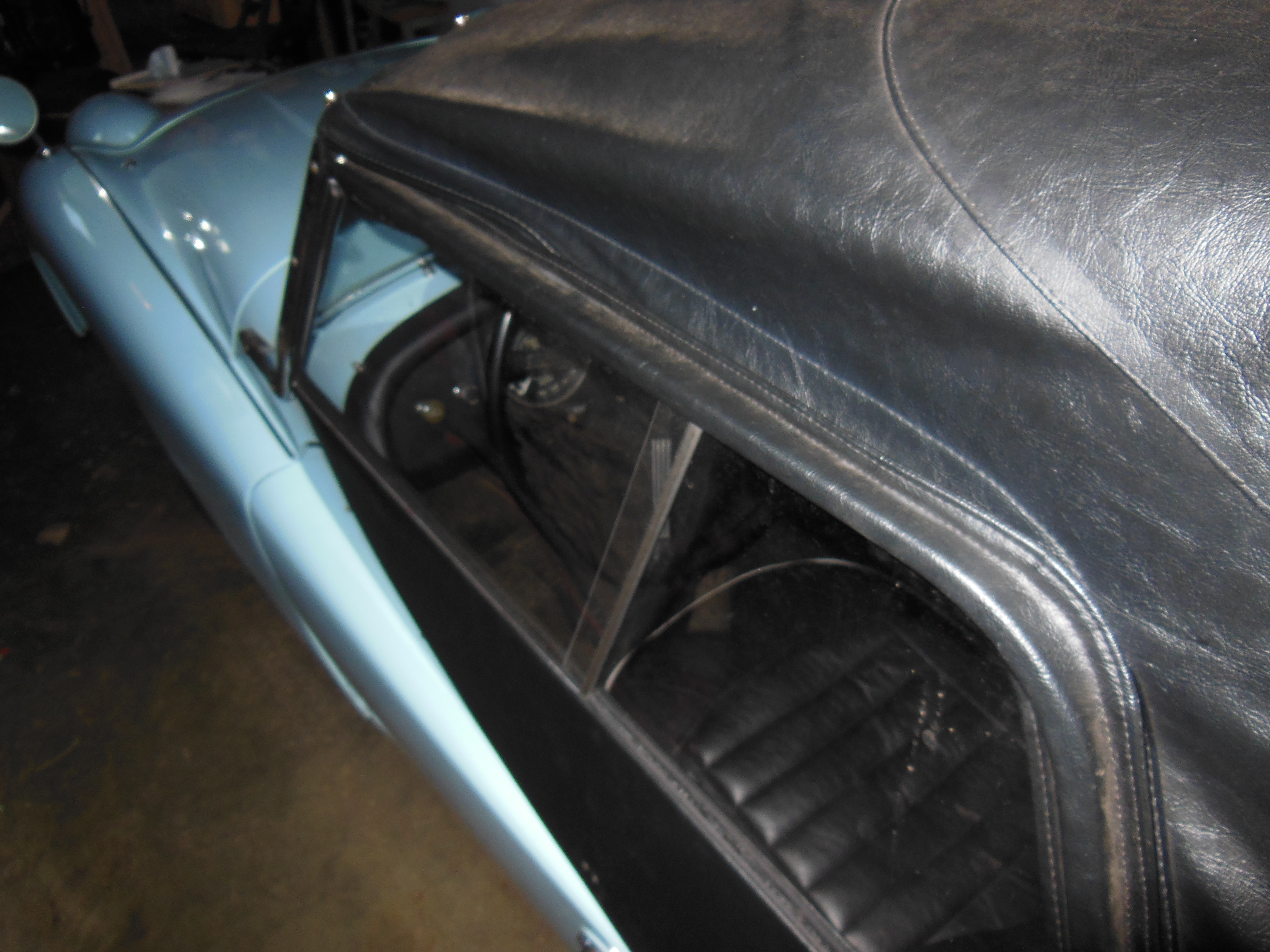

You can see from the attached pictures that there is a significant gap between the top and the door window on the left side. I didn't get the top centered perfectly, so the right side has no gap, but even if it were perfect I think there would be a small gap on both sides. The top just doesn't seem to be wide enough.

Yeah, that will leak badly. On the TR2/3 the glass fits inside the sewn pocket. Is there any adjustment in the window mechanism to correct the top of the glass upward?

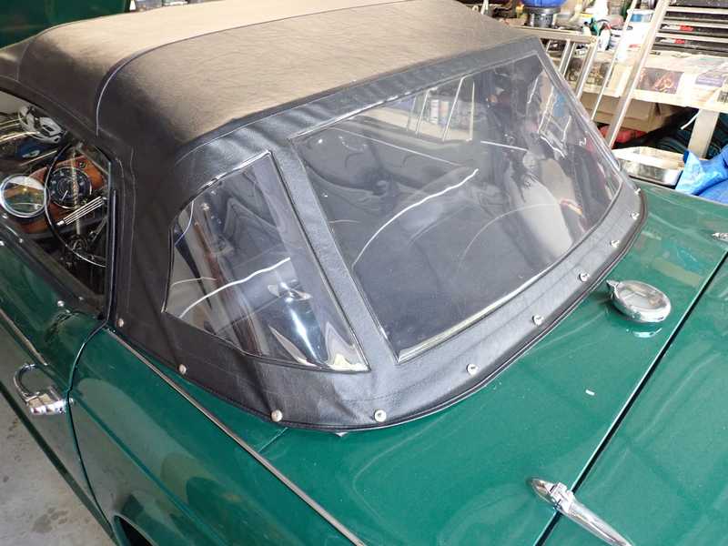

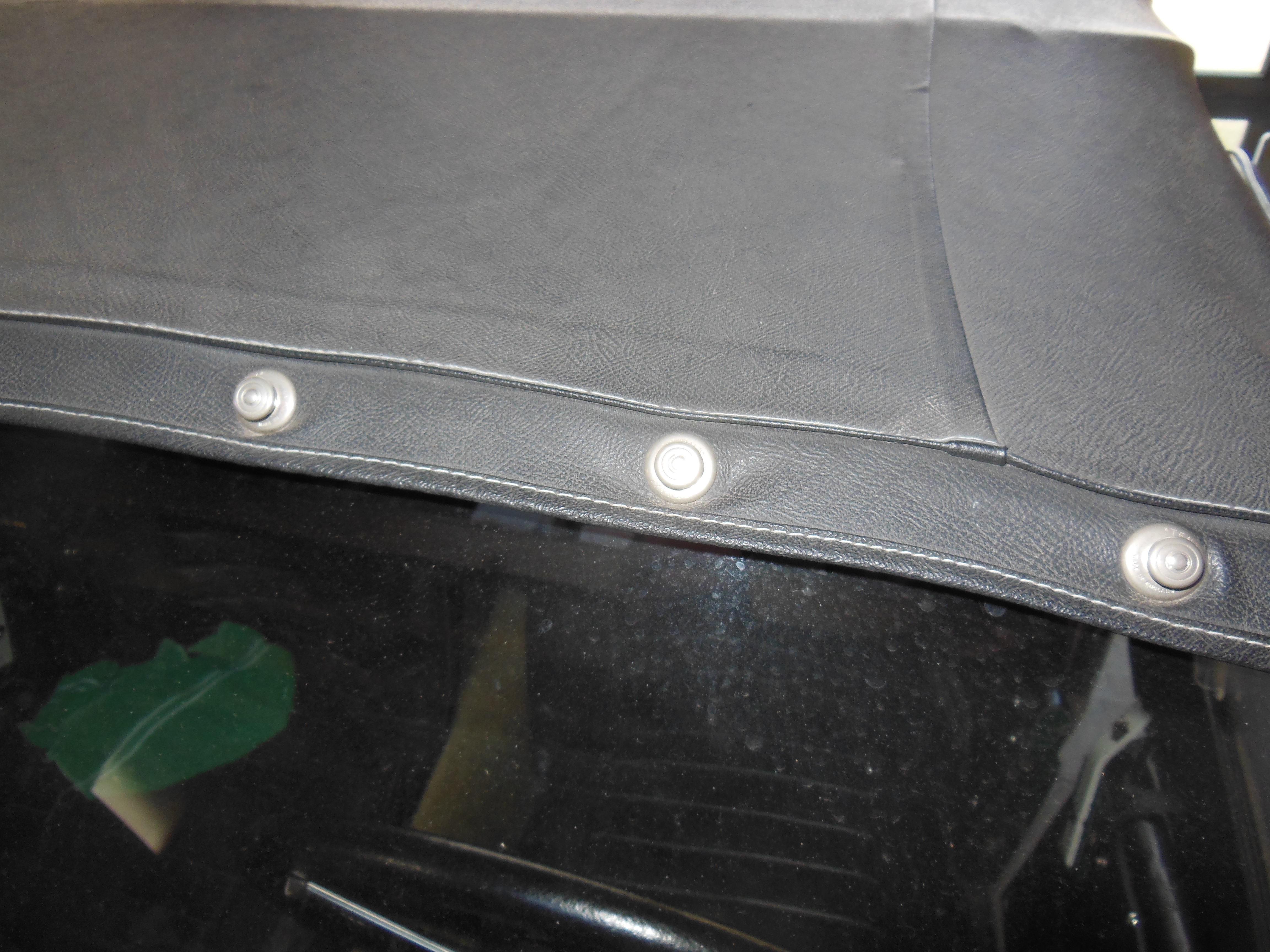

The rear of the left window looks (from the slight wrinkle in the top material) that it could be stretched forward by relocating a couple of the lift-a-dots.
The top looks very tight in the fit like it could be the wrong top. When I put a Robins top on my tr3, the top felt too small front and back and is too long on the sides, the opposite of your problem and I need to fix mine also. I did not like working with the Robins top, too tight too small

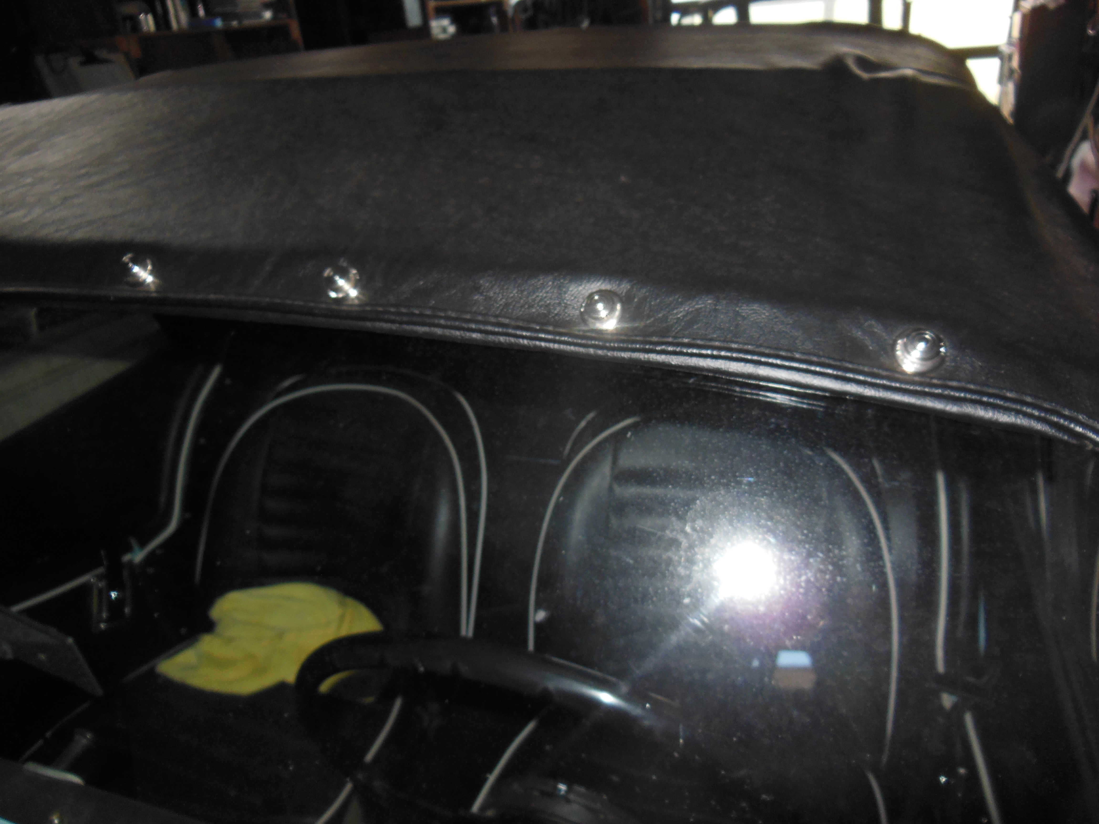

It looks to me in the photo that the second and third snap from the door are pulled back too far. The bows in the center look too tight. Maybe on a hot summer day you could hold the section over the doors down somehow with something and then push the bows up and try to stretch the vinyl down at the doors then leave the car in the sun for a while.

Yes, the window tops should slide into the pockets when closed. This keeps water out (mostly šŸ˜€). It would be interesting to see the top of the window at the a-pillar - is the window going up far enough?
Having said this: I had to stretch my top all kinds of ways to get it to fit well. Ultimately it does fit very well, but I was sore after installing it! The top was hot and soft: I used a heated blanket on the outside plus a space heater inside the car. I pulled hard outward when mounting the rear edge. I pulled hard both forward and to the sides when attaching the leading edge. Then pulled the rear windows down and foward to match the door glass.
The Robbin’s material shrinks over time. If your top is more than a few years old, it might need additional stretching (heat and muscle). For the same reason it is recommended to keep the top up in the winter.

This is a new top, installed two years ago. The wrinkle in the corner windows is from the snaps, which just don't hold. I have parts to replace them with something that will, but that's a separate problem.

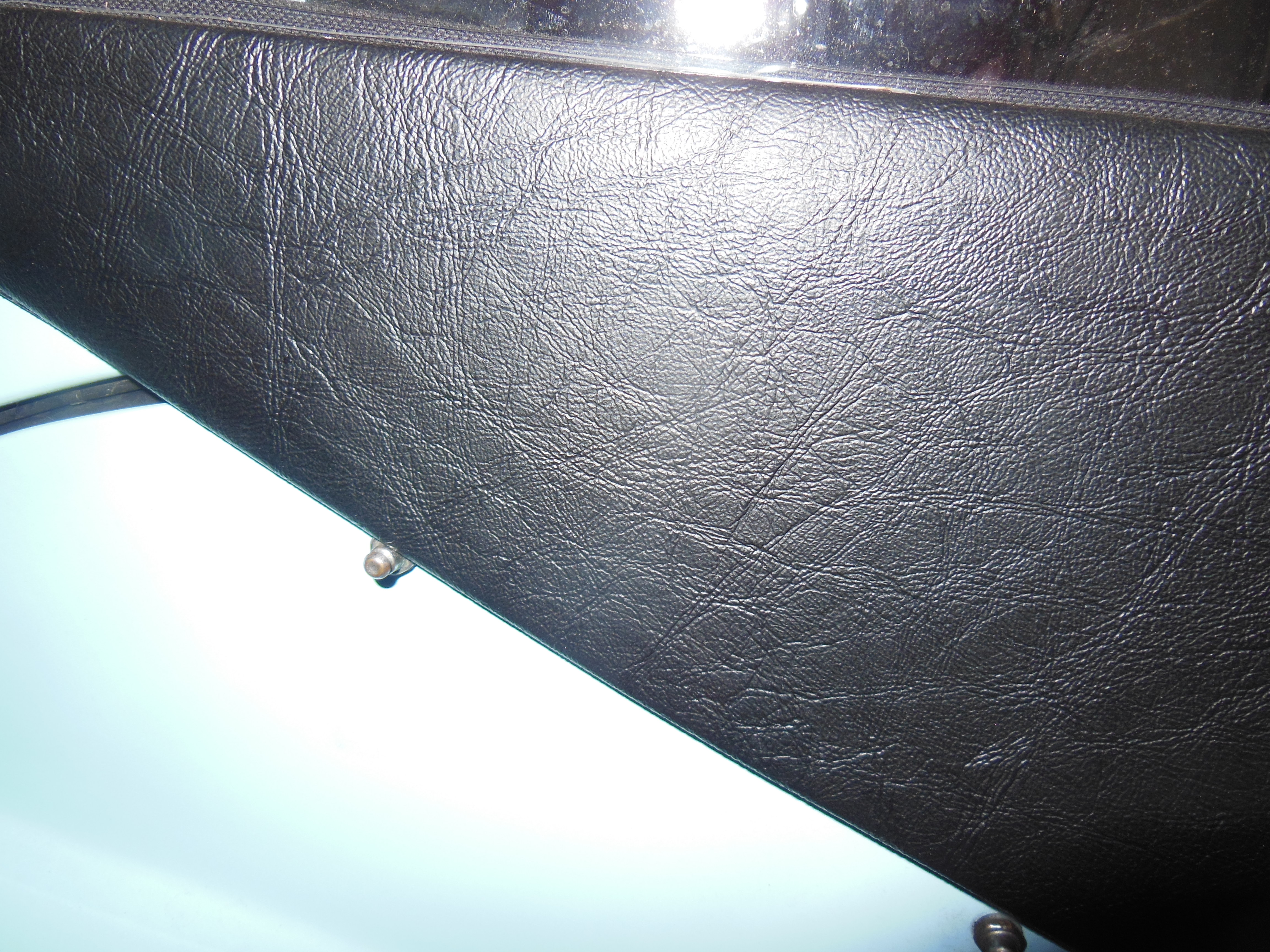

I put pictures to show how the cut is different from the 2 tops. The Prestige top had a seam going along the front edge and the Robins does not. The Robins top probably seals better, but I find it too tight. I have not driven Robins topped car in the winter because I am still fighting the proper door closer and waiting for summer to try and fix it. I liked the idea Popeye had with the heater and heating blanket. Heck my hands cannot pull like they did, also.

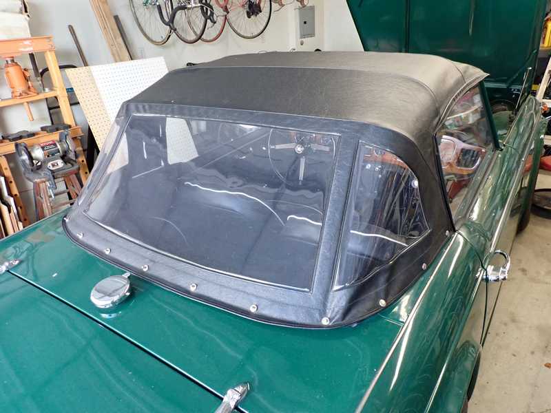

Just one more post to describe the resolution of this problem.
In short, I got a Prestige top and installed it. When I looked at them on-line, they were on sale, so I got a new top for about $300, shipped, which I think is a very good price. It arrived promptly, but this point I don't remember exactly how long it took. I like the top; it looks good and is well made. Returning the old one to the Roadster Factory obviously was not an option; I will just eat the loss. It's not a big part of the restoration anyway, and I simply cannot live with the gap between the top and window.
Installation was a little difficult, more so than with the Robbins top. You will see a couple of ripples in the pictures; they look much worse in the pics than in real life, probably because of the overhead lighting in my garage. It took a lot of work to get it this good.
