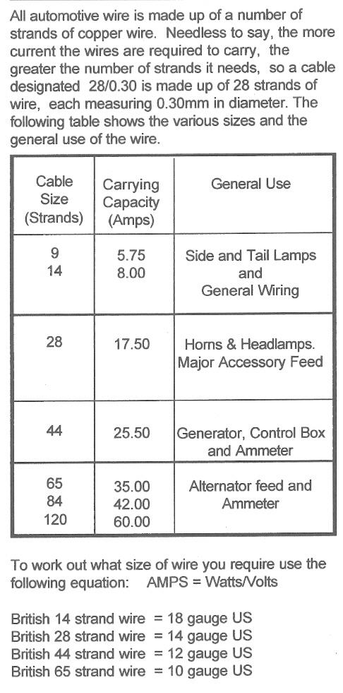

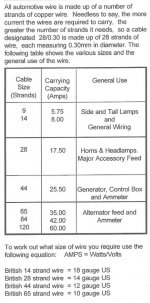

I am going to replace the existing wire to the main generator terminal (currently 28 strand, but cooked by the manifold) with 44 strand wire. Once I attach the female spade, I will put shrink tubing on as well as the cover provided by British Wiring. And over the entire wire, I will put some high-heat resistant sleeving.
