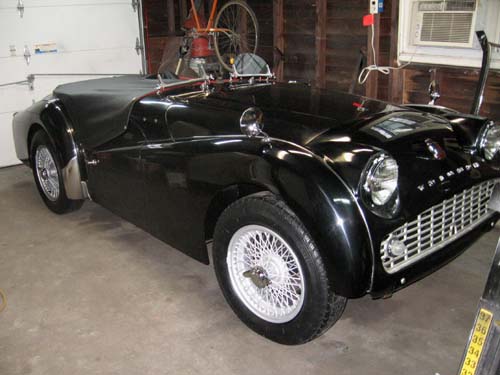

It's quite possible to do yourself. But, as mentioned above, preparation is the key. The panels must be as perfect as you can possibly make them. I was painting in black, so I knew that any imperfections in the body work would stick out like a sore thumb.
As far as concours goes, remember that these cars never had "clear" on them. So, if you brought it to Pebble Beach with clear on it, you would most likely get points deducted. Besides, I feel clear is out of place on these cars.
I painted the TR in the garage and am quite happy with the results. Perfect?? NO...does it look good?? YES.
BTW, I'm still installing the tonneau cover, so yes, there are missing snaps.

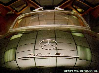

Did this a number of years back... Black. The "grid" is the reflection of the office ceiling. The resolution ain't great but it was a TON of work to make the car "right".
