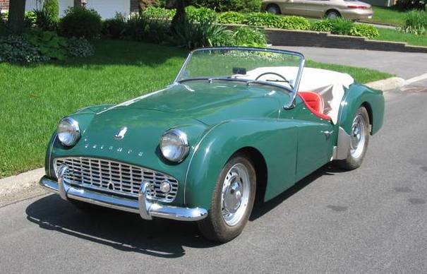

On the late TR3A I restored, the owner had not run the engine for the four years it sat in his garden under a tarp - after it was plowed sideways along the highway by the front bumper of a Freightliner. He told me the engine had been re-built and improved just before the collision. During the seven years I had it for the restoration, I checked the compression (cold) several times. The readings were scary ! 100, 20, 20 and 50. The owner told me not to do anything to the engine. When it was all finished and ready to run, it warmed up nicely and I re-checked the compression while it was still hot. I had the throttles (butterflys) fully open and had removed all 4 sparkplugs. The readings were 170,170, 165 and 165.

Are these two dif cars or pre repaint? I suspect they are two and do you still have both?

My own TR is a black 1958 early TR3A. I bought it brand new 49 and a half years ago. The green one is a late TR3A that I did for the owner who lives in Toronto. Attached is a photo of me with my car taken at VTR in Colorado in 2001.

Both cars look great.
