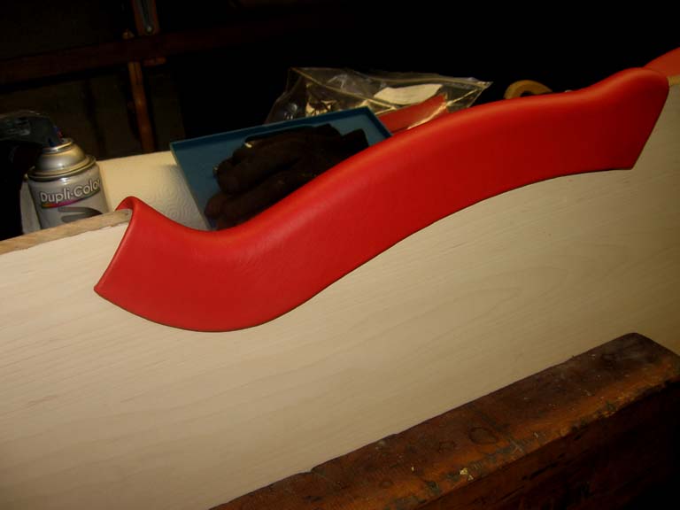

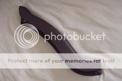

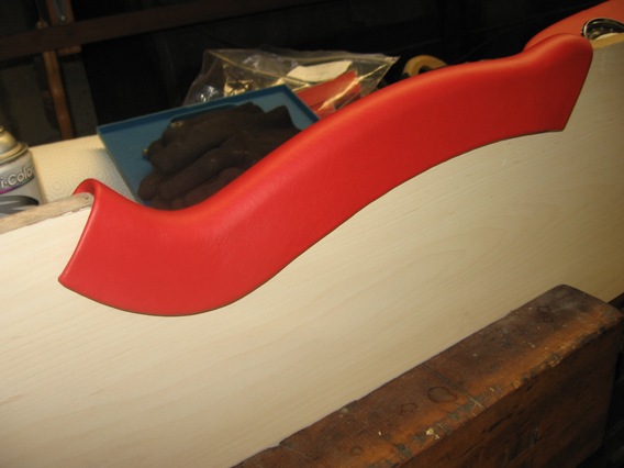

I did my whole interior with leather, including the dash and all of the cappings. It actually is probably easier to work with then the vinyl. You can use water and heat to help you along if needed, especially the dogleg piece behind the door.

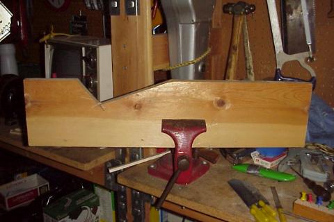

You might want to make a jig to help out with stretching the leather. I believe the idea is from Geo Hahn, but if I'm incorrect, please advise.
The last pic is mine.

...I believe the idea is from Geo Hahn, but if I'm incorrect...
Yeah, those are mine -- 13 years and 3 garages ago. This is the finished version from back then:
I soaked the leather quite awhile in warm water before beginning. As I recall the metal shell was held to that board with a small nail (or two) that was easily withdrawn when the rassling match was over and the leather forced to conform to the shape.
Seems to be holding up well in the years since.
...Do you remember what glue you used?
Main thing I recall is that I used very little.
Probably a quick spray of 3M 8090 on the edges of the leather to make it grippy and another spray on the inside of the metal shell.
You only need to hold it long enough to let the leather dry (from the wetting) -- then it has assumed the shape and not much adhesive power is needed to keep it on.
Once it is installed it can't come loose as the tight fit of the cap over the top of the door clamps it in place.

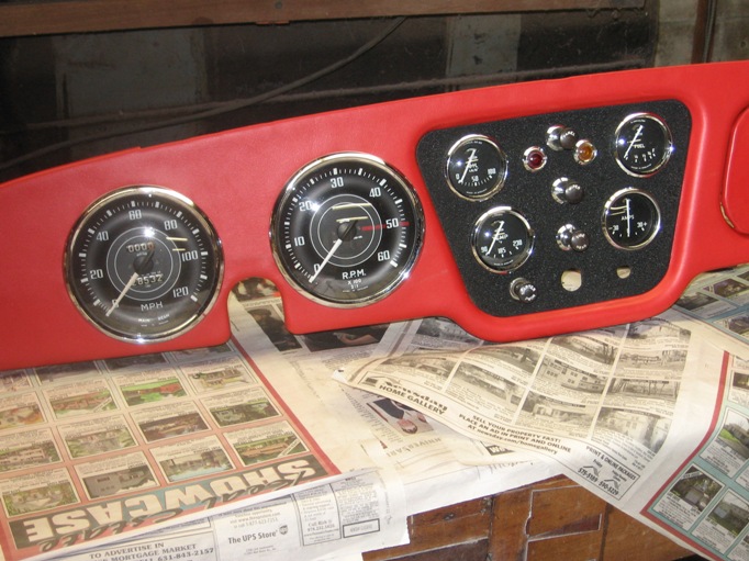

I didn't use any nails, as I found the design of the jig was good enough not to require them. And I too soaked the leather in warm water for about 15-20 minutes. I also had a heat gun handy, but it wasn't needed very much on the cappings. However, the leather on the dash did require more use of the heat gun.
