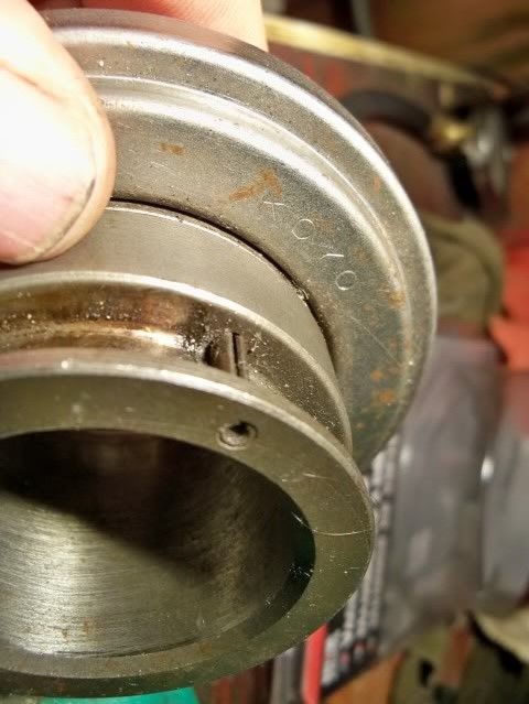

Is there an 'anti rotation' pin on the bearing ?
If not the bearing might be good, it's just spinning on the fork, which the pin would prevent.
In my experience, at least, some clutches just do that. Unless the noise is accompanied by something more troubling,like a grinding noise or feeling, I don't think it is anything to worry about.
That's odd.....I've never seen that pin on any of the throw out bearings I have bought from the usual suppliers Is this something new. or just for TR4's? Who sells it.
It's pretty common on the steel version of the bearing carrier for the 4A and TR6's...I'm not sure about the 4 if it's different or not though.
I think the TR4 used the same Sleeve as the TR3A/B so no pin would be present. If I remember correctly the OEM TR4A sleeves were brass/bronze and steel OEM came out with the TR250/TR5.
