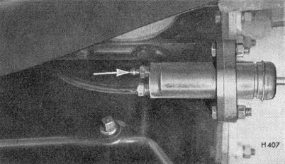

This is a first for me, but I have a sickening feeling I know what the answer is...I removed, cleaned and put new seals in my project TR6's clutch slave. (The car had been sitting for a long time and the slave looked like it was weeping.) I didn't see an internal snap ring or a place for one to seat. When I put the slave back in and tested it after bleeding (I used a one-man air-compressor-fed bleeder) fluid started shooting out from below and the piston seemed to be halfway out of the cylinder. No matter where the rod is attached (center, top, bottom holes) the result is the same.
So...the question is: did I do something stupid, or is the clutch disc so worn that the travel is too far for the cylinder and rod? Remember, I bought this car non-running, so I have no idea what the clutch is like. The thousands of dollars of new-in-box parts included a new clutch kit, but I was really hoping I wouldn't have to pull the tranny and replace the clutch. (Plus it's an O/D box, so even more weight!!!)

Oh god...I think I just figured it out while writing this...did I mount the slave to the wrong side of the bracket!!!?!?!?!?!?!?!?!?! (I'm not at my garage right now, but I have a sick feeling that I mounted it to the car front side, not the rear!!!

Yup...I did what I thought!!! I mounted the slave to the front-of-car side of the bracket. I just swapped it and spent a bit of time bleeding and it works. (Probably could use more bleeding, but I'm out of time.) Just goes to show that a guy who has owned seven TRs and who has swapped/rebuilt clutch slaves on plenty of them can still do something totally stupid!
But it runs. I went in 1st and reverse. (Only about four feet, since it is wedged behind my truck in my last garage bay.) But maybe I'll throw the plate on it tomorrow and take it for a drive!!!
