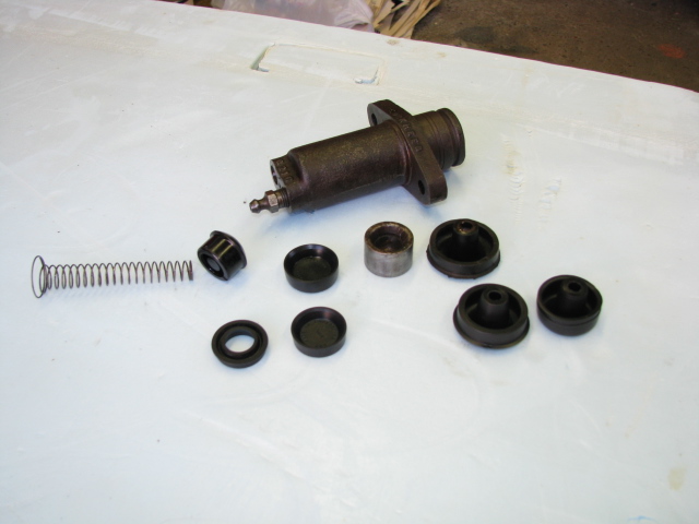

could someone tell me these are the correct parts for my clutch slave. The top row is what came out, the bottom row is the new kit. Parts are from Moss and there tech people are not in on weekends......I'm trying to do an attachment so bear with me please......dang...it worked....

Little hard to tell, but looks good to me assuming the cup (2nd from left on bottom row) fits the bore. Don't use the extra parts, they are extra.
I'm thinking, but not sure, the bottom left part replaces the top left part...the black rubber pieces. It would be the parts that connect to the spring. but I have to reverse the spring to connect the two. If any of this makes sense. I know it's awful hard to tell from the pic unles you actually encountered this problem. Thank you
