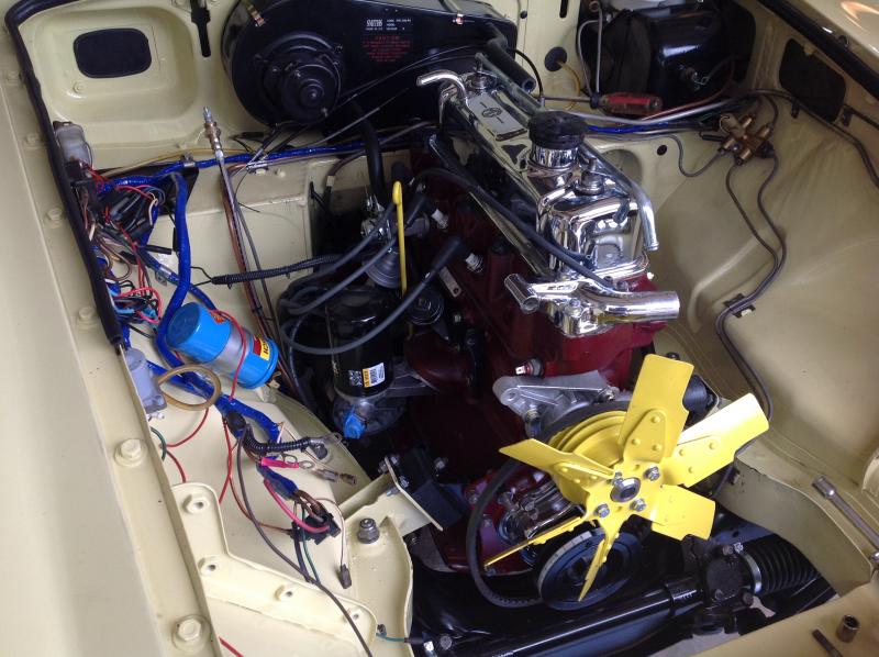

It seems like the clutch hydraulics are a pita to bleed on every LBC and I started putting remote bleeders on the slave cylinders a few years ago. It allows access without getting under the car and gives the air bubbles a place to go even while sitting. It’s no more than a flexible hydraulic line screwed into the highest port on the slave cylinder...I used a Speed bleeder on mine, but a regular one works a treat. This is the one on my 70 MGB.
