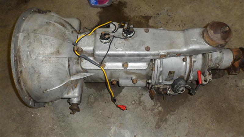

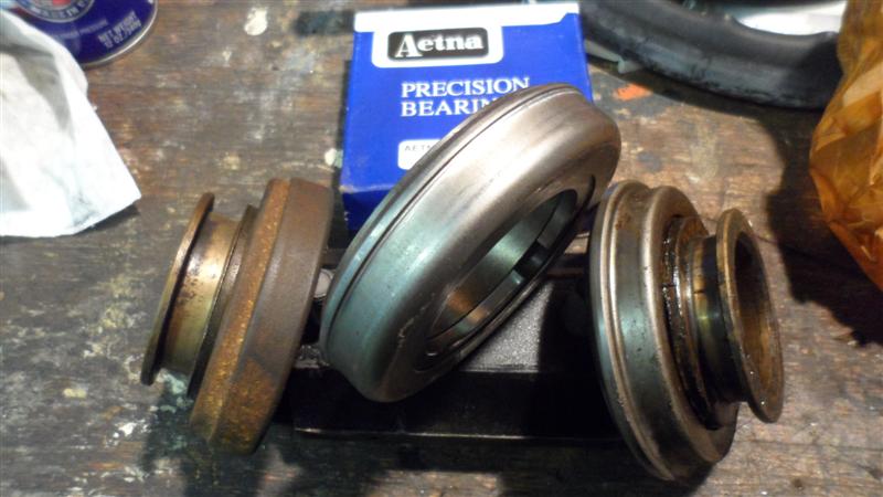

Randall, I seem to have fallen into somewhat of a mess. The TOB on the left is the one that came from the TR3 transmission. The one on the right came from the TR4? overdrive setup. Finally the one pictured in the center is the one that came with my new clutch kit. Besides not having any place for the carrier to ride the Id is much too big. The clutch and pressure plate seem to be for a TR3 as they match the ones that came from my car. Any ideas?

Donnie,
Both carriers looks the same lenght to me. You have to press the carrier out of the TOB and the new one should press right back on it. New TOB OD is larger but shouldn't make any difference riding on the clutch.
Marv
The TOB in the center appears to have the curved face used with the 4A clutch. On the right looks like an original (type) TR3 TOB & carrier. I can't tell for sure about the one on the left.
ISTR the 4A carrier fits farther inside the bearing, but it's been a long time and I'm not certain.
I had mistaken the lever and prongs inside the transmission as what you guys were referring to as the carrier. I'm not sure how to press the carrier out of the old TO bearing and into the new? I'm still confused as the new bearing I received with my clutch kit has a much larger inside diameter and will not ride on the transmission input shaft collar. Does that make a difference.I'd hate to put it all together and then have to redo. The picture shows the left bearing which came from the TR3 transmission, the right bearing which came from the TR4 overdrive transmission with the small clutch and the center is a new one from my clutch kit.
Maybe I'm using the wrong terminology, the factory calls it the "bearing sleeve". Anyway, by "carrier", I mean the piece that presses into the throwout bearing, and then rides on the transmission nose (carrying the bearing).
ISTR I cut down a pipe cap to make a mandrel to press out the carrier from the old bearing. I think TRF sells a tool to install the bearing while rotating it, to (hopefully) avoid damage to the bearing; but I just pressed it in. The Buckeye article at https://www.buckeyetriumphs.org/technical/clutch/ReleaseBearing/ReleaseBearingWoes.htm shows the use of the tool.
