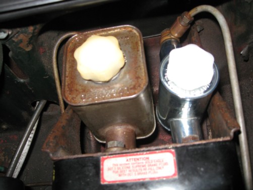

Unlike many of you, I am a novice at car repair. Everything I try is the first time for me. Today, with some direction from a couple of friends, I replaced the clutch master cylinder in my '64 MGB....and it works. I'm always amazed when it works.
Now under my belt is this project, water pump replacement, SU jet replacement on the front carb, seat reupholstery, carpet replacement, interior panel replacement, shock absorber replacement, fuel pump replacement, and a few other minor projects.
Next project.....getting that distributor out, sent off for a rebuild, and back in with all that comes with it.
